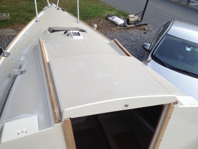

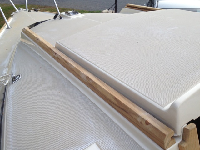

I've got the sliders off now, ready to go cut the new ones to bevel and length. Think I will Marine Tex the old holes, and then be able to place the new screws where I want them.
Did you use sealant down the whole length of the sliders? I want to, so that dirt won't collect underneath as badly.
Brian
Nov 9, 2012
2,500
Oday 192 Lake Nockamixon
Well, I did my hatch sliders this weekend, and they don't look terrible. I think I may have spaced them about 1/8" or so too far apart, but, hey, they are holding the hatch in place, so that's good. When I went to screw one of the screws in, and pull the wood down tight to the glass riser, it split the wood. DOH! (I actually said other words... you get the idea.) And also, pounding some of the bungs in, they kinda split, because they were being put into that tapered section of the wood. So, I guess I'll be filling the split and those bung voids with wood flour thickened epoxy. One thing I noticed was that O'day had drilled the screws in at an angle, inwards into the fiberglass. I did not do this, and it showed that my holes into the fiberglass were further outboard than the originals. Oh, well, if they don't work out, I'll re-do them again in a few years. But I think they'll be ok...
Then, sanding, and Cetol.
I also sanded the toe rails, and reinstalled the hatchboard sliders. I know I need to install new toe rails, but I just don't want to go to the trouble this year. Maybe just get one more season out of the originals? Please?
