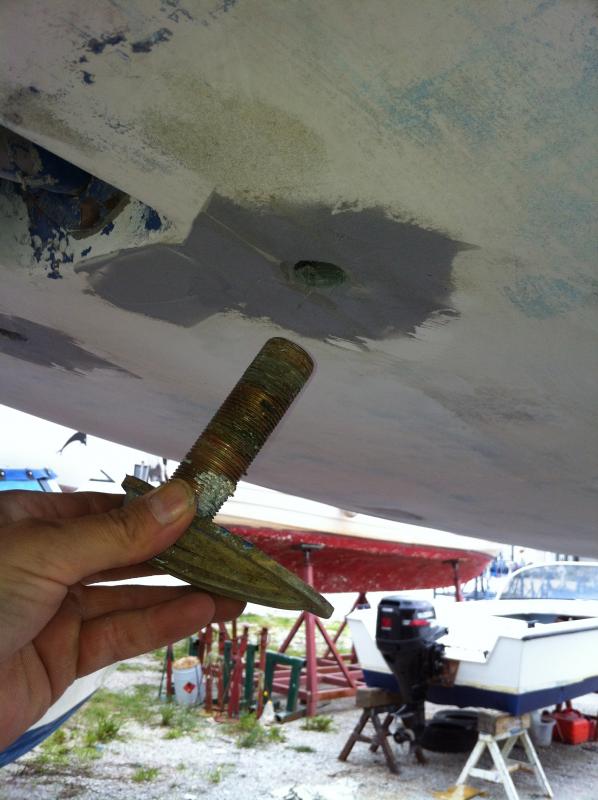

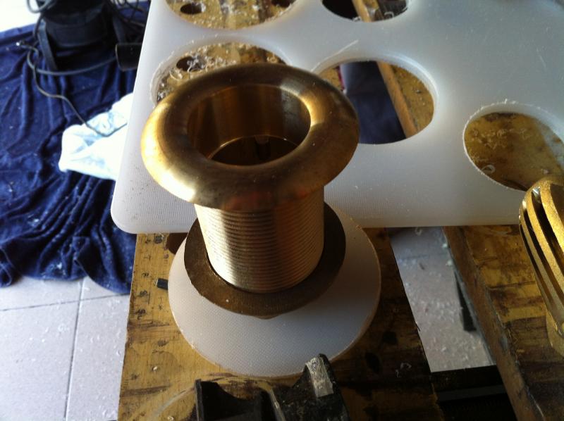

Hello to all friends, as you may have seen the post HELLO WE PRESENT, my wife and i we are currently restoring a Hunter 35.5 , things are going well, but we wanted to know what can be the value of this boat when you are finished the restoration, " I will not sell the boat!" But we want to find the right balance, the spending to do, not to exceed by far what is its real value. There are so many options, you can put, but you cannot exaggerate ...

Maintenance includes just about everything else, much like what you pictured. Just because a previous owner neglected your boat doesn't mean that what you put into it means it is any more valuable. For example, neglected seacocks that didn't get exercised and need to be replaced, do not add any value to a boat. Many boats have skippers who do not neglect standing and running rigging, or seacocks or blocks, but don't get premium prices for their boats.

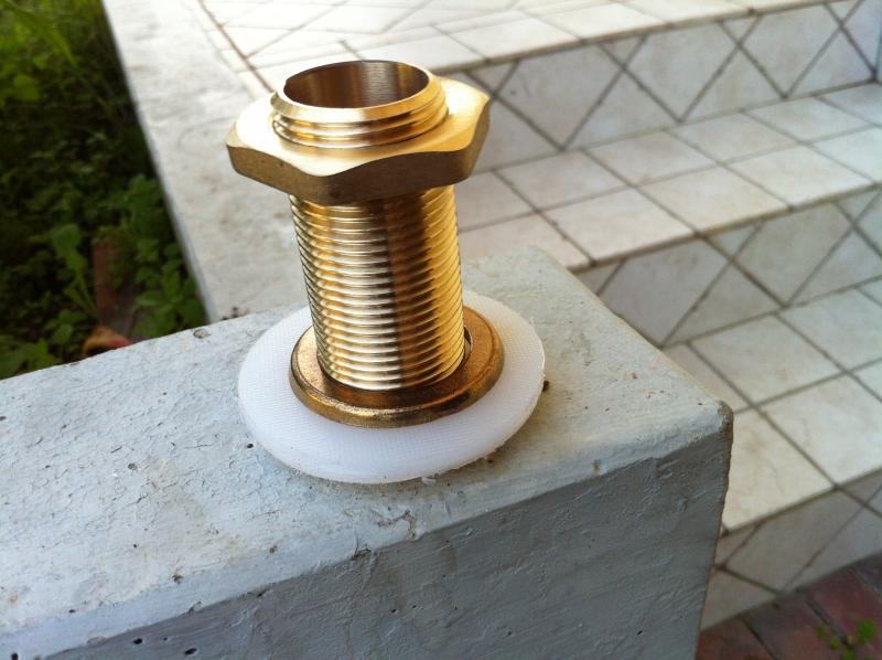

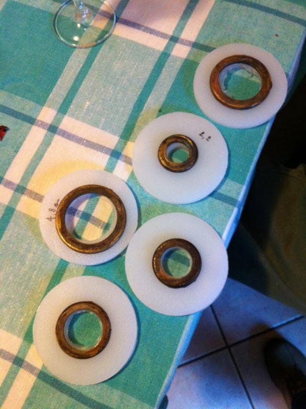

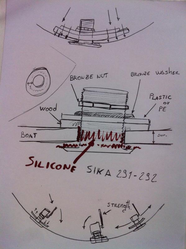

IF those circular bushings you cut were out of a cutting board or any other Polyethylene material you are going to have problems on two counts,.
1. Polyethylene has extremely poor bonding to anything, with especially low strength with chemical adhesives.
2. IT creeps like you would not believe, put pressure on it and it will flow and flow and flow.
Hope what you were using for that application was not a Polyethylene material also called PE, HDPE, UMWPE etc. not a good choice for any compression seal of any typel

I would not use the material you are showing in pictures....You will never get a good bond because nothing will stick to it! Find and cut up some old fiber glass panels or pieces and do that instead.

Yes you are right. What you are seeing is a washer in P.E. thick 1 cm. Serves to distribute the force under, and decrease the vibrations on the nut, under ec a reinforcement of wood with resin, the seal with the water it is with this special silicon, sikaflex 292 or 291 that acts on a very large surface on the hole of the hull. Thanks and aspect other councils.
