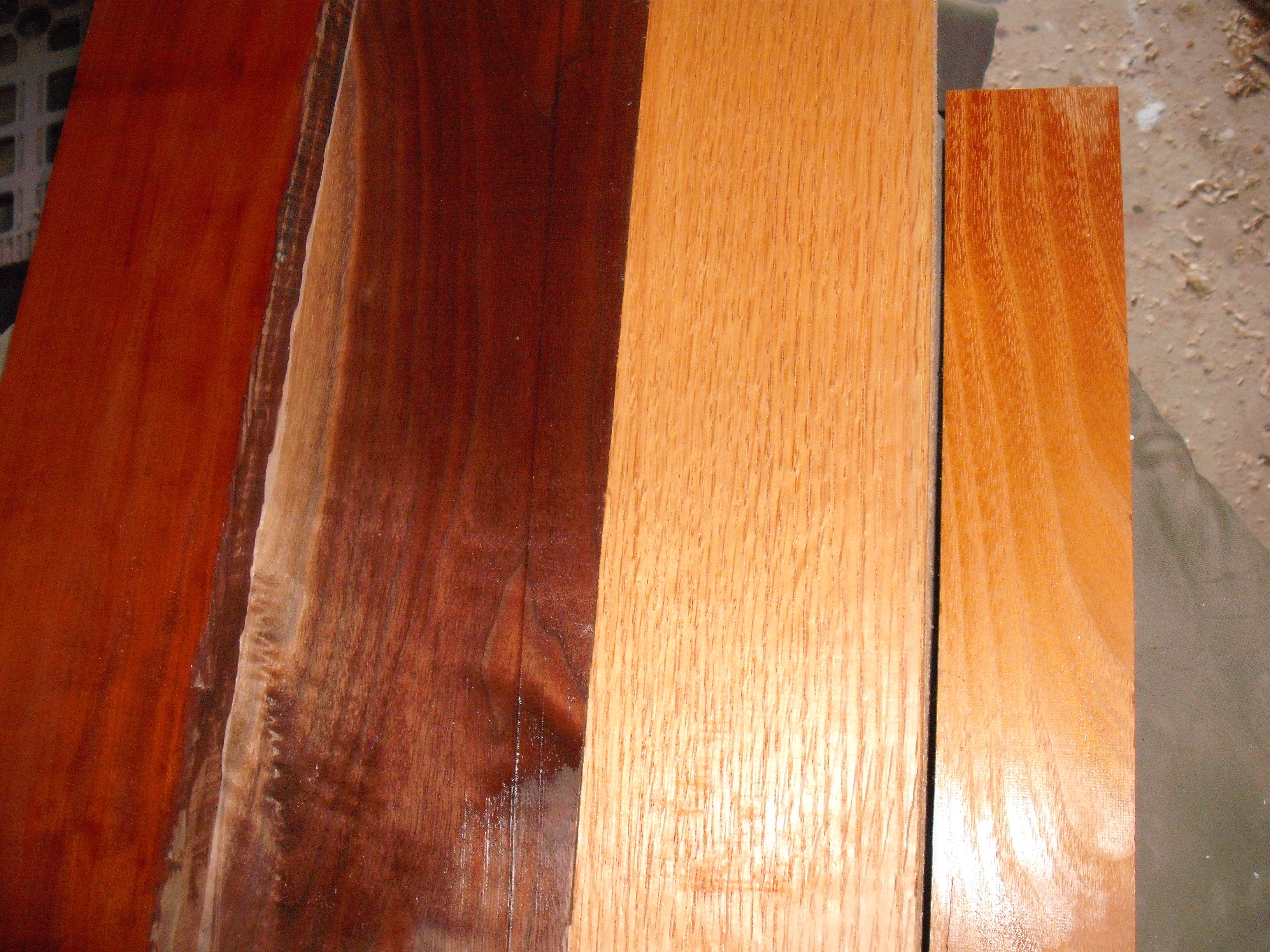

Here is a pix of 4 native hardwoods grown and milled locally.
from the left there is cherry, black walnut, red oak and locust.
