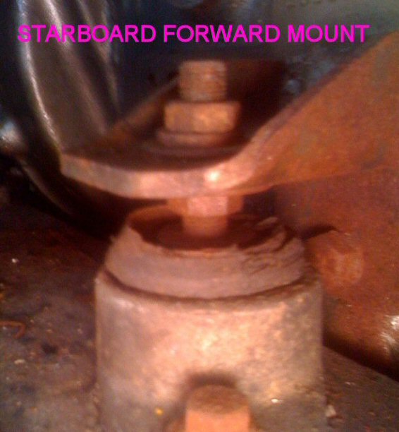

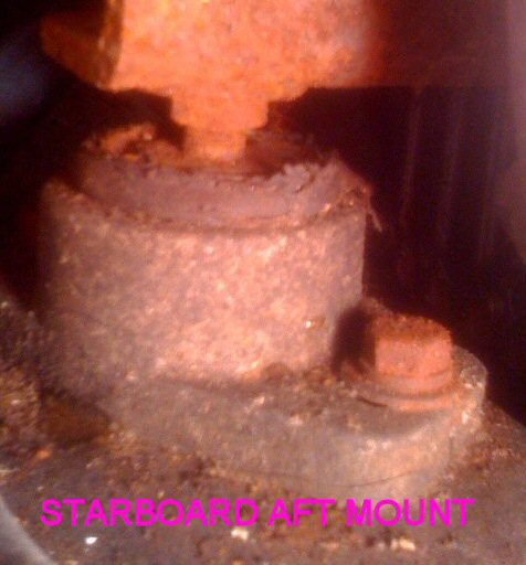

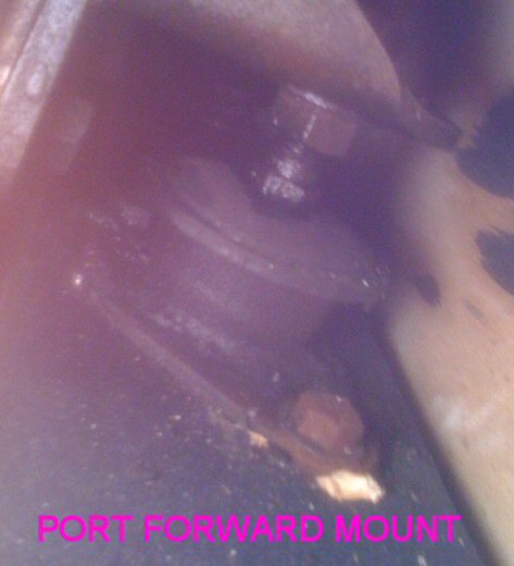

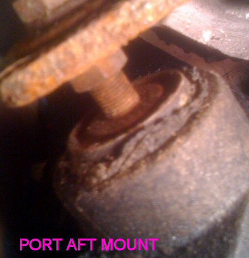

In an effort to diagnose where a thumping noise is coming from, I suspect the engine mounts may be to blame. Can anyone tell from looking if they're indeed shot and in need of replacement. They ARE old. I assume they're original equipment and it's on a 1979 Hunter 33 (Yanmar 2QM15)
Photos are attached.

That rubber compound ages, breaks down, and flattens over time. The metal parts can corrode and weaken.
Yours are about 10 years beyond their replacement date, IMHO.
Replace 'em all. Lots of good choices in OEM or aftermarket.

One of the easiest way to assay the integrity of engine mounts is to use a long pry bar and 'gently' lift the engine away from the mount - if the rubber component 'separates' from the 'metal' (dont get carried away as you can break a mount with a prybar) when you slightly/gently lift the engine - then the mount is 'shot'.

I would also suggest using OEM mounts. There are some stories about using the aftermarket mounts that are not pretty. On many of the Yanmar engines they use different mounts in each of the positions (fore/aft port/starboard) so just be sure you get the proper ones and they are located in the proper positions.

I WAS hoping to get by with just a shaft re-alignment, but after taking a good look and getting all of your responses, it looks like it's mount changing time!
