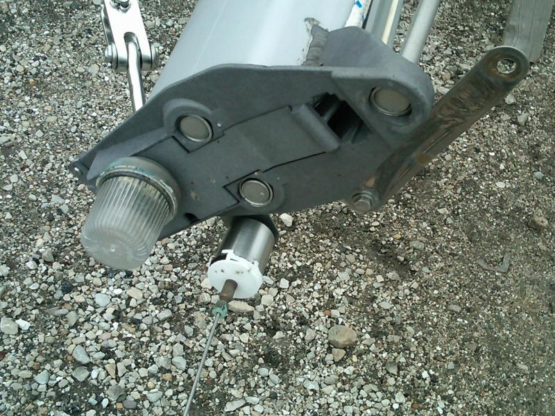

My Hunter used the Isomat mast. Does anyone have a picture of the masthead on these boats? I'm thinking of fabricating something to hold some antennas and a three way light and I'd like to have an idea of what I'll see up there before I get into the harness.

Rig-Rite has some blowups of a couple of Isomat mast heads. Youmight try looking at their website to see if those are helpful.

Photo of masthead
Rig-Rite will have some drawings and information on masthead. This is a photo of our Isomat masthead, however there are a couple of different styles. Our mast is an NG-51.
