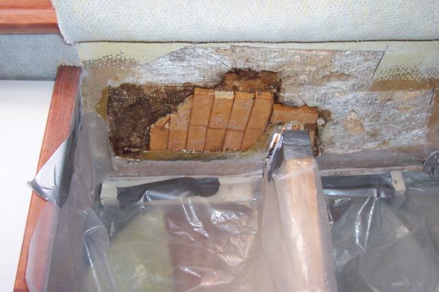

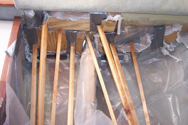

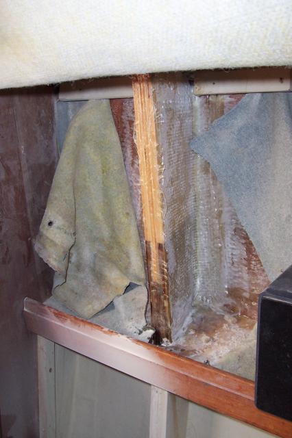

Here's a few pics of my 9.2c port main bulkhead repair. I repaired it with git rot this spring but wanted to cut out all the bad stuff. First pic is during the recoring of the deck from below. I had cut it open, removed the bad core and let it dry well for about two weeks. Then I replaced the small area of bad wet core in the deck, replaced the cut out sections from below and braced them in place until the epoxy cured. I also put two layers of woven roving all over the new and old wood and the hull. You can see in the pics I made the repair out of 3 pieces of 1/2 ply, the middle piece extending down 3" into the original bulkhead. The top of the bulkhead has been epoxied to the underneath of the deck. Lots of epoxy and silica for thickening were used. All edges have been sealed with epoxy. I epoxied around the chainplate hole so any water coming in will not do damage again. I replaced the carpet and it's invisible. It's nice to be able to wack the repair with a ball peen hammer and have it bounce off!
