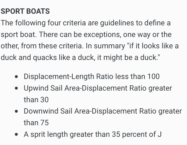

First, breaking out sport boat is a very good idea. They sail a totally different race. It usually a ratios thing. Lake Michigan PHRF does the following. Like they say, 99% of them will ‘Look like a duck’.
Get those guys out, then just go spin / non-spin. Some will do PHRF ratings bands, but I would not do that in a fleet of less than say 40 boats. You can have a ‘cruiser class’ if you want, but I really don’t understand that. Your boat weighs an extra 1000 pounds, your sails are old and the guy on the j30 really know how to race and kicks your butt. But you still want a participation prize.

Re breaking out the sport boats, very few people will argue with what is and is not a sport boat
Flying tiger 10M
FarEast 28r
Megles 24
J80
etc
Some of the Js closer to 30 feet get iffy, like the J92s. I like to think that anything with a diesel can't be a sportboat!
Your club's model would have the First 36.7 and the J/109 in different fleets. That would be sad, those two boats are natural enemies on the racecourse. Separate out the sporties, and any boat with a kite should sail it its rating.

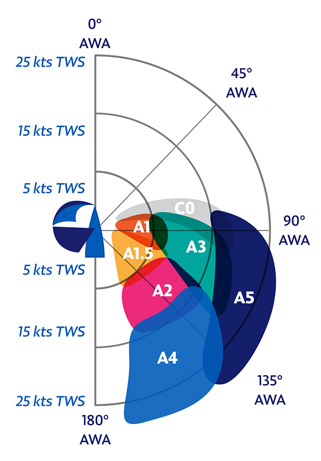

If you actually have a Code 3, its not designed for deep work at all. Designed to reach, that kite will not rotate in front of the boat, and be a miserable experience with the wind aft of the beam. A good A2 would be a better choice, and look like this going almost DDW. With the tack eased, look how the luff rotates to windward, pulling the sail into clean air. Crew on the that side helps too!

Looks like I need an A2. Looking at the chart, pretty sure I have an A3. I thought the sailmaker called it a Code 3, but I may have read that somewhere and it stuck in my head. As far as the difference between a Code 3 and an A3, I guess whatever the sailmaker wants to call it. And someone told me the Doyle UPS that came with my boat is basically a Code 0. I will look at my sail info and see what it says, including what's stenciled on the bag.

There is a key difference between Code and 'A' sails with the same number. Code sails are designed to be measured JUST large enough in the mid-girth to not measure as a genoa. An 'A' sail will have more area. For sure, the best general purpose asym is the A2. With its curved luff it will rotate and sail very deep, and with the tack pulled down still sail to a decent apparent wind angle as long as you drive the luff carefully. Same sail, doing 5 knots in less than 5 knots of true breeze. Often the luff will curl over about a foot, that's OK.
