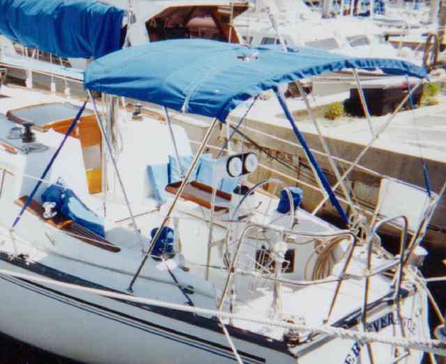

Ken, here is a photo of the bimini on bay horse. It was there when I bought the boat and has served ok. The ties adjust so that the boom just misses the bimini top as it swings downward, (topping lift missing or loose) It has been left up for many months at a time with no particular problem other than just weathering the fabric. It even weathered 48 hours of 40 50 kt winds fully deployed in a near miss hurricane just before I got the boat. Leaving the boat, I usually fold it up and protect with a cover which also has the splits for the backstay. As you can see the backstay adjuster tackle also goes up through the backstay hole. Not a perfect solution but it does work. Indications are that my boat has had a similar rig all its days.
