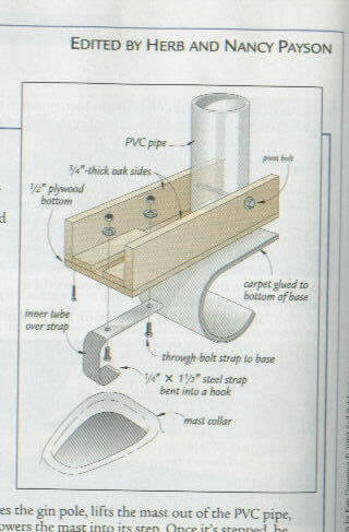

What is this?
What is this for? Is it an aid for steping the mast?

yes, Kelly, it is supposed to help one to be able to step the mast singlehanded. I tried to submit the total article on the website, but it was to big and it was rejected. So I had to crop the photo down to just show the portable tabernacle itelf. Be sure to pick up a copy of the Sail Magazine, September, 2003, pg 116, article "Things that Work". It will explain everything. I have not had time to build one myself yet but as soon as I can I will, at least to give it a try. I find that trying to step the 27' mast myself can be an exciting ordeal and I have been trying to figure out something to make it easier and less dangerous to myself and anyone, or thing around me when I do step the mast by myself. AFter reading the article, I thought that others with O'Day Daysailers might benefit from the article. If you cannot get a copy of the Sail Magazine, I will be happy to copy and send the article to you if you wish. Fair Winds, Gary
