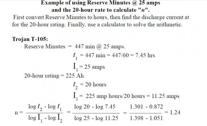

here's an example of how to calculate it using the Trojan T-105 as the example. It is from the Link 10 manual:

Ok, so I ran the calculation and came up with 1.12. I also got a response from Deka (who I asked to provide the #) and they indicated that it is 1.20. So why the difference and which is correct???
Nov 13, 2008
39
Hunter 27 Jackson Harbor, Chicago
The link in Blitz's message gives me 1.12 using the 20hr and 2.9hr rating, but if I use the 20 hr and the 3.3 hr rating it is 1.10 and if I use the 2.9 and the 3.3 hr rating I get 1.55, and Deka told me it is 1.20
I thought this was suppose to be a constant exponent for the battery, why does it come up different depending on which the batteries ratings I use? I am still confused as to which # to use.
