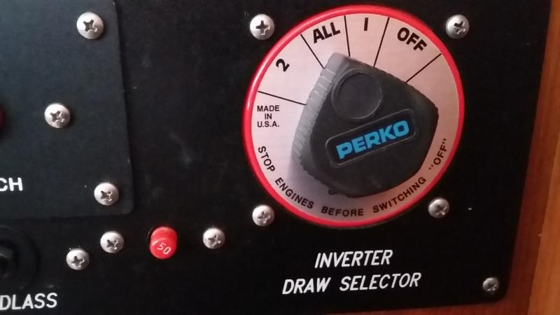

Hello
I am having trouble charging my two domestic batteries on my Hunter Passage 42. The alternator is only charging the starter battery. I have the Perko engine switch on and the Perko Inverter Draw Selector swiched to all but, at the nav station the charge is showing 14-15 volt charging to the starter battery when the engine is running but, nothing on the domestic batteries. Of course I wish all batteries to be charging when the engine is running.
Any thoughts or remedies would be much appreciated.
Regards to all from the UK
23,092
While someone with your boat may answer, in any event it would be difficult to answer this question without know how your boat is wired.
For example, does your alternator output go to the Perko switch or to one of the battery banks? Do you have a combiner, echo charger or ACR? Is the Perko switch what most of us call a simple 1-2-B switch?

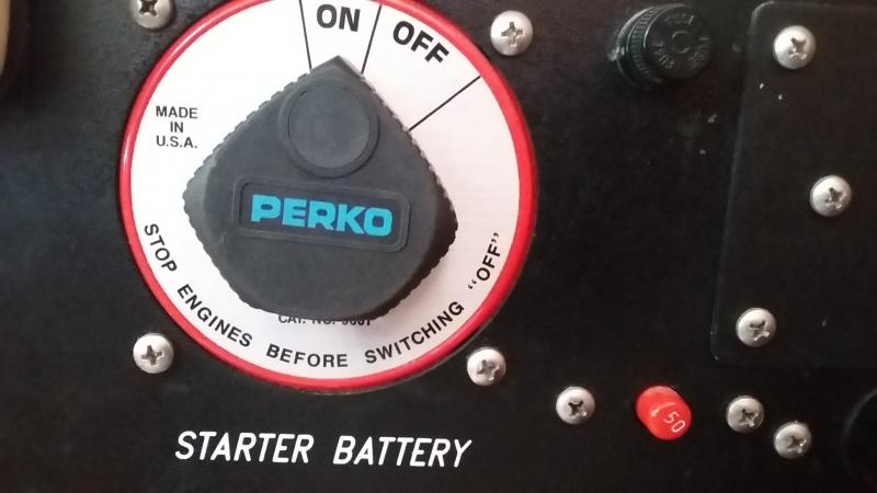

Hello Eianm. Thank you for the information. I am trying to include pictures. I have the Perko engine battery switch to all and the battery inverter select to all but,no charging of the domestic batteries is taking place with the engine alternator. The engine battery and two domestics are only charging when the yacht I'd plugged into the Marian electrics.

On my 1991, there is another perko switch above and between the start battery and the passageway wall, it is turned away from your view, as you would look at it from the aft cabin battery access hatch. Mine was for "alternator" destination....start battery or house bank or all.
You might look for another Perko in the engine bay, else start making a wiring diagram to sort things out. As far as I know my boat was still "factory" but can not say for sure.
