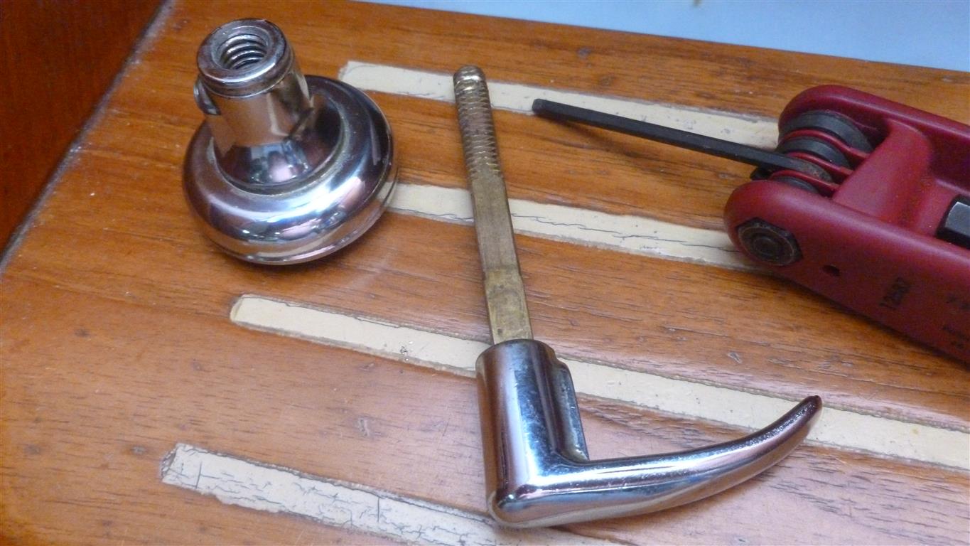

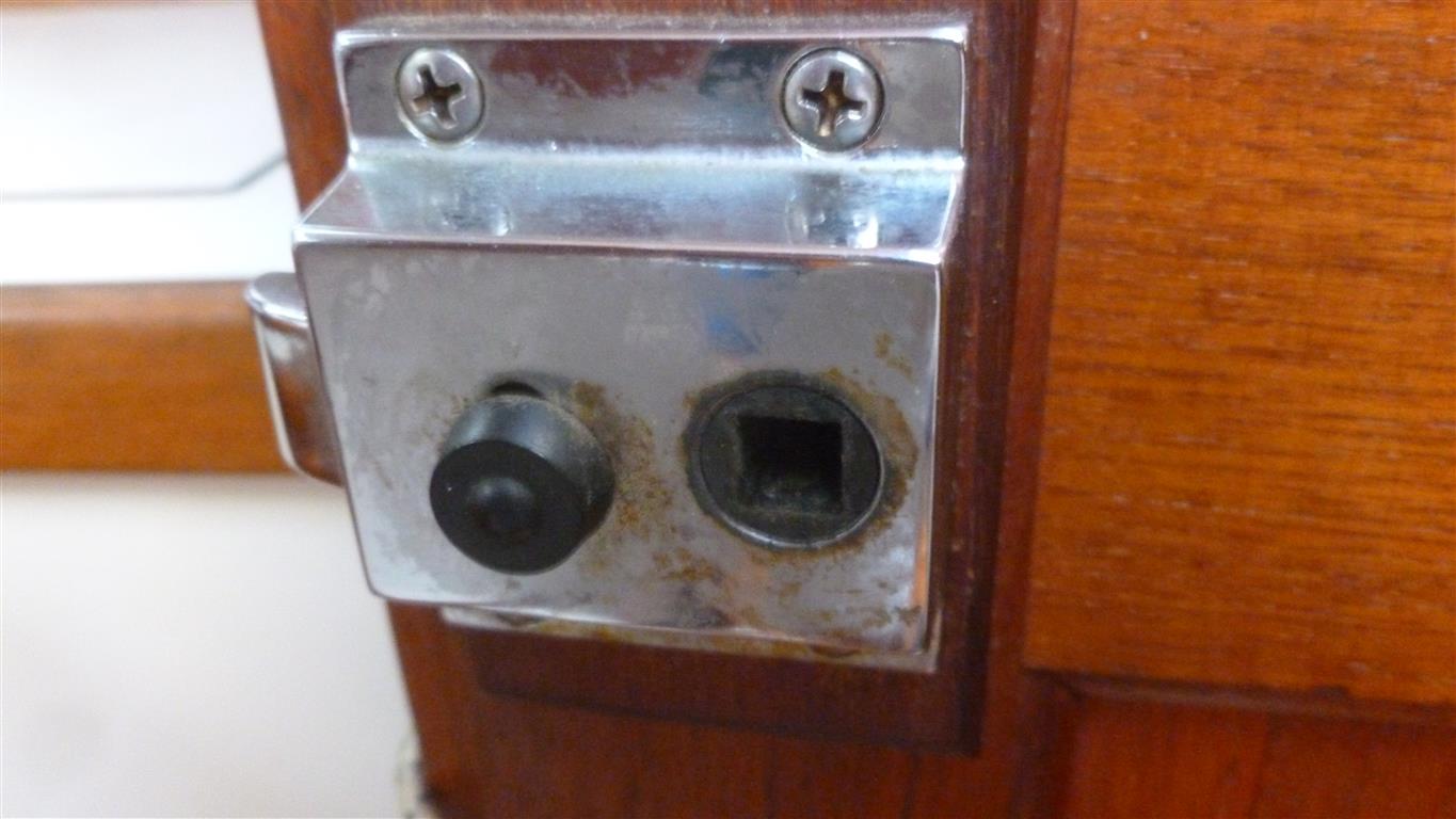

Is the round knob facing you on the outside? Or is it the lever handle?

From the pics,
If that's the model Perko, you might get some two-piece thing through the square hole; and then, as you twist it, flip the lock button?
