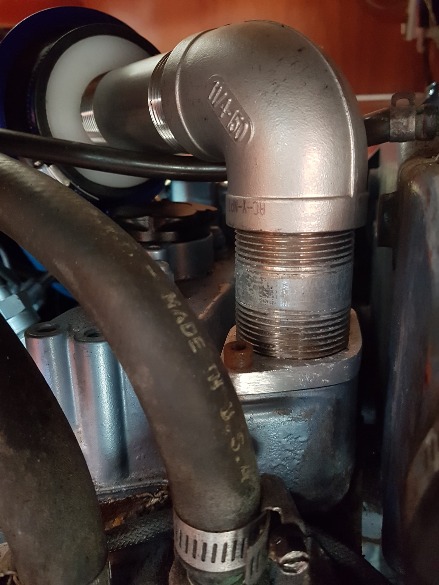

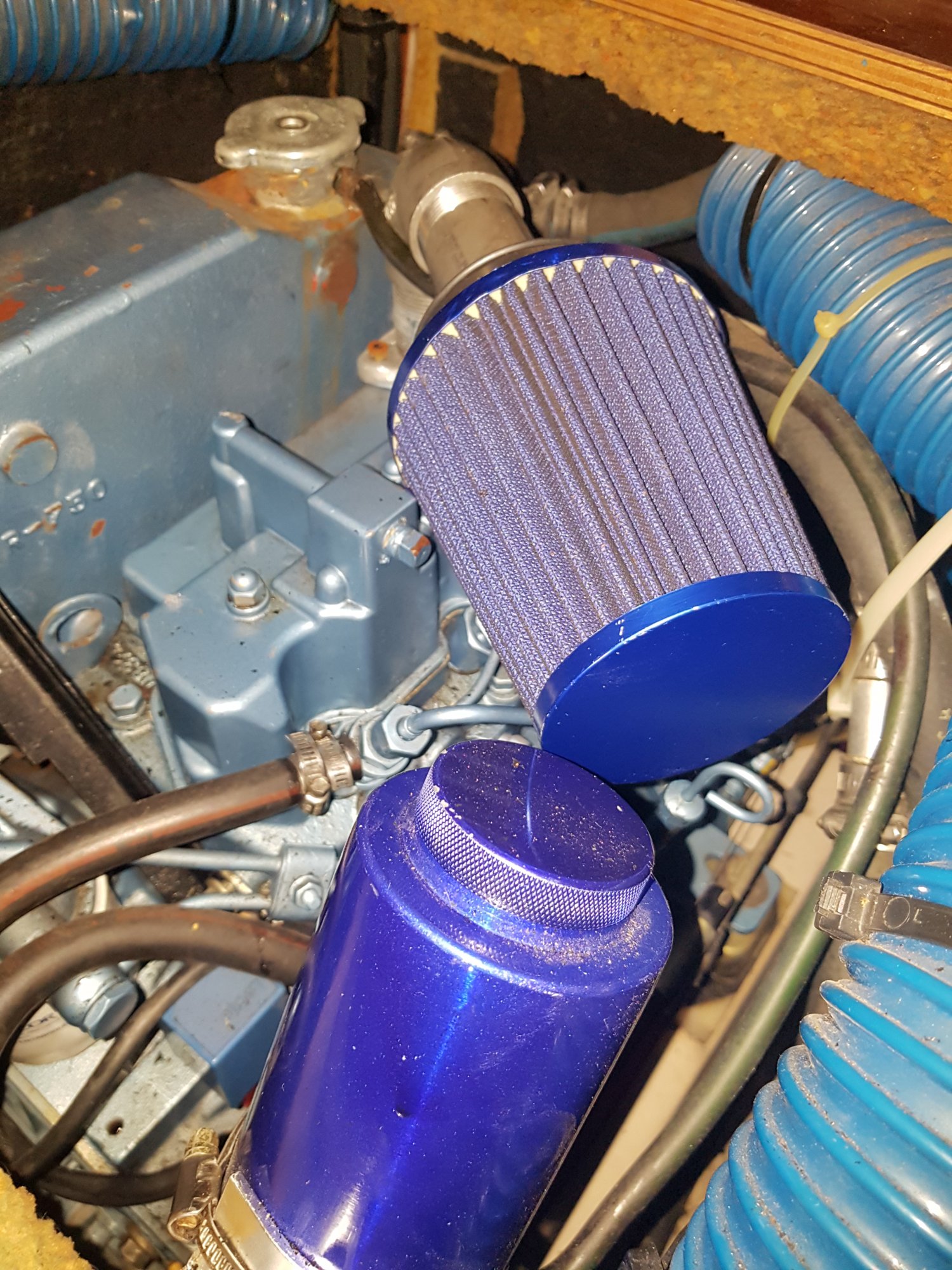

Here's a few pics of mods made to my m30 . I added an air filter engine came without one. I used 316 stainless pipe 1 1/4 and machined a plate . Bought washable filter off ebay Added a recover tank off ebay

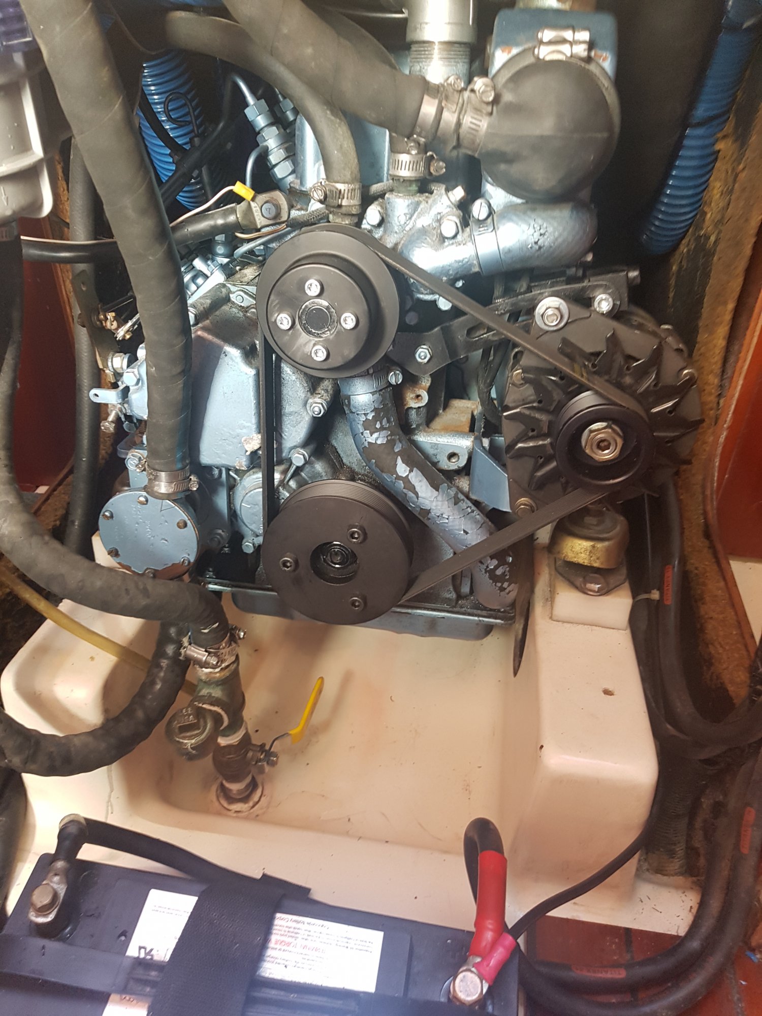

for cooling system and converted v-belt to serpentine drive and machined up a belt tensioner
