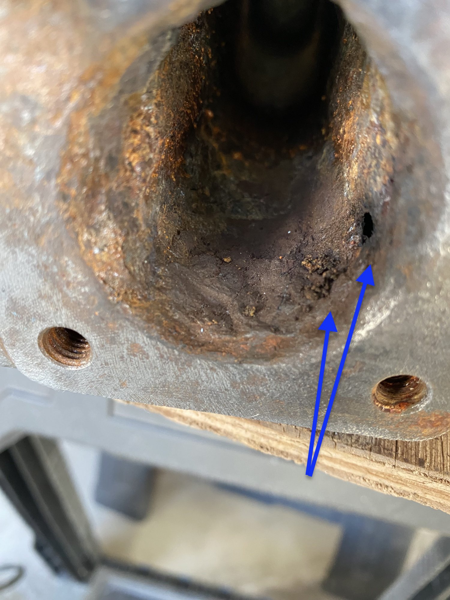

ddines
Jun 15, 2009
5
2 29 Salem
Congrats on tracking down the problem, good detective work. I am writing to inform other who have the M30 to be on the alert for the problem I discovered. The heat exchanger is subject to significant corrosion with diesel and salt water mixing in the exit of the HE (where the elbow attaches). Mine had developed a hole between the exhaust side into the coolant area. It was so brittle those small holes expanded into a huge hole which was difficult to patch with epoxy. Ordinarily the pressure from the exhaust should push the saltwater from the elbow out and away but on shut down which could allow salt water back in also leaking from the coolant into the exhaust area could find its way into the cylinder and cause hydro lock.
New HE's are very expensive and hard to find ($1500-2000) and many are shipped from overseas. So I tried buying a used one for about half that price and they shipped me the wrong one. (There are 2 types: cast iron and aluminum and switching types is possible but would require new hoses, and modification to the mounting). Plus the used one had enough corrosion on it that it would probably not seal. Despite his assurances that it would fit and that it was in usable shape, when I returned it, I had to pay shipping and a huge restocking fee. So my advice is to inspect any used one carefully before or bite the bullet and buy a new one.
Hopefully no one else encounters this but put it on your list of things to check when encountering a difficult to find issues.
