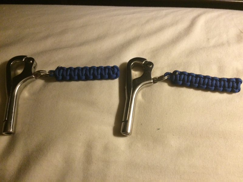

Hooks received and learned how to make a Portuguese sinnet lanyard for each of them. Can't wait to see how they look! Assuming something like earrings for a boat. Lol

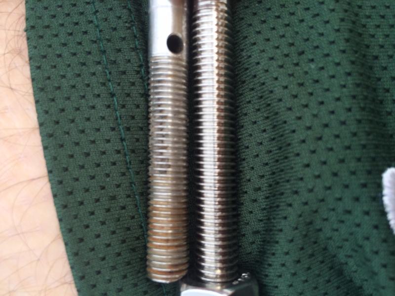

Super frustrated at this point. 3 strikes so far.
Strike 1: Suncor S0162-0007 - 1/4 RH Thread (thread too small)
Strike 2: Suncor S0162-0008 - 5/16 RH Thread (right size - thread direction wrong)
Strike 3: Marine Part Depot - 5/16 LH Thread (thread too coarse - looks like I need 28/in. instead of 24//in.
From what I can tell, only 1/4" comes in 28/in.
Pic attached. I may end up replacing the entire lifeline gate with a new swage but that's my last resort. Any advice would be greatly appreciated.

Rather than guess just take fitting to a machine shop. In less than a minute they can use tap and die set to measure your thread size and pitch.

tapping out the threads is easy. Left handed threads in that size will take someone with an extensive inventory.
Since I assume your sitting on all three still as long as the outside diameter is the same on all of them and they just put different holes and threads in all three. Your going to want to take in the smallest of the three.
If you take one that is really close to the right size he wont have enough meat to tap it out meaning when he is done it will be a very weak set of threads.
If you take the smallest one then after he drills it out to the correct diameter starting hole you'll have a full set of professional threads.
You may have thought of this already just wanted to throw it out there.
I have a very extensive tap and die set from when I was doing industrial maint but don't have but a few left handed.
Your other option that's just as good is to DIE out the swag and personally I believe that would be the easier option to try before trying to replace it.
Again die it to the smaller size you have that is right handed and there ya go

Thanks guys. I think I'm going to start over and go back the the hardware store to find out what size I'm dealing with. The first time they had no clue but I'll grab the owner this time and I'm sure he can figure it out.
From their I'll figure out if that size is available or order a smaller thread and try to tap it to the size I need. I just did some reading and tap and die methods and it does look pretty easy. I have a drill press so I should be able to do it myself with the right size tap. Unfortunately, everything has been returned at this point. Riggingonly is a great site that didn't come up in any of the searches I did so thanks for that ref. too. Thx again.

Follow up; the threads are 5/16, LH, 24/in. Marine depot dot com sent me 20/in, I mailed them back and never got a refund.
