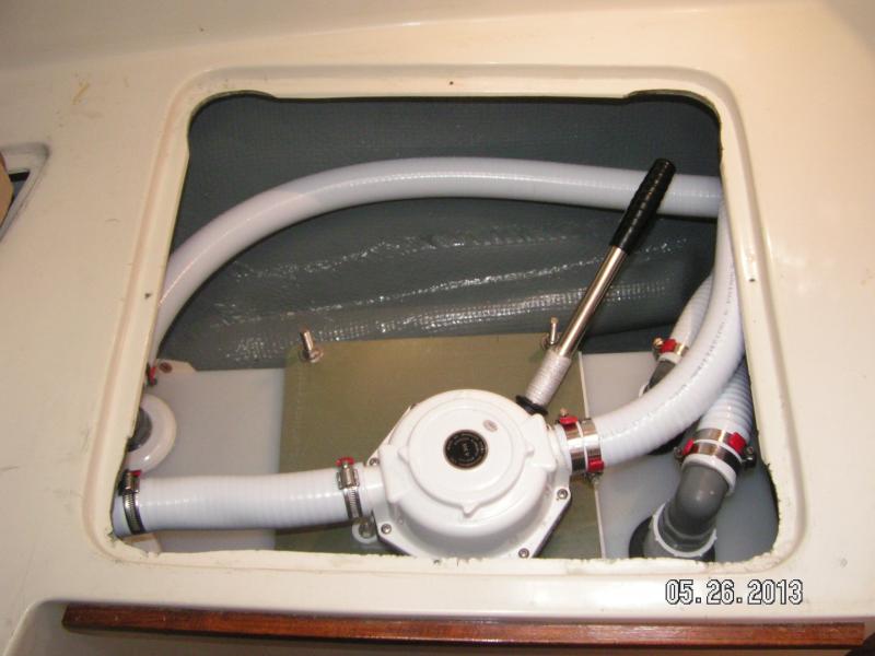

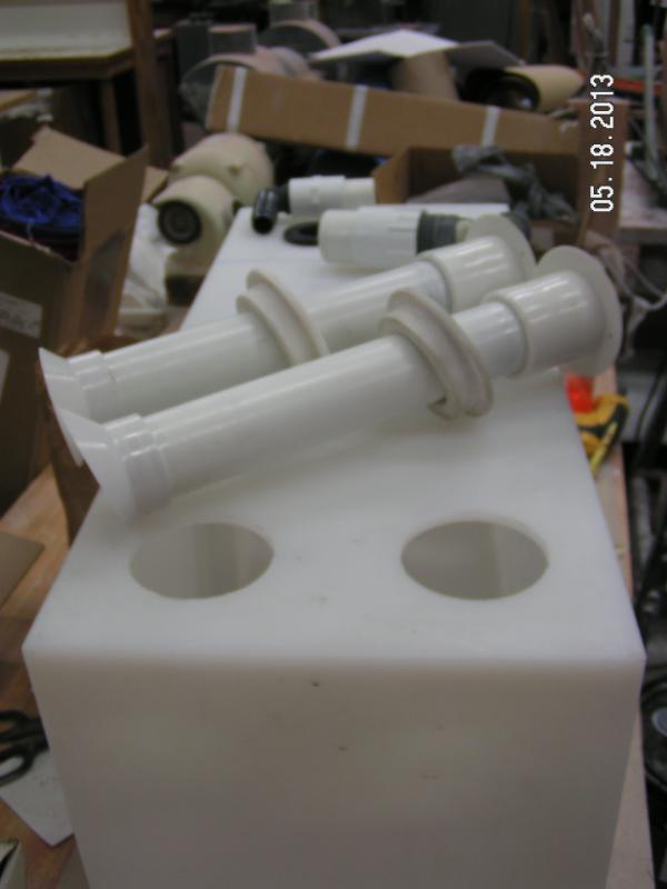

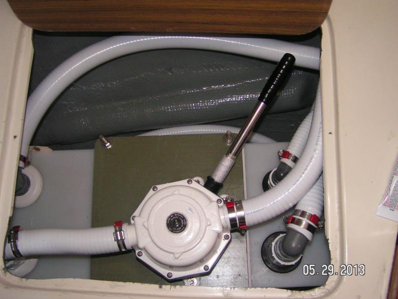

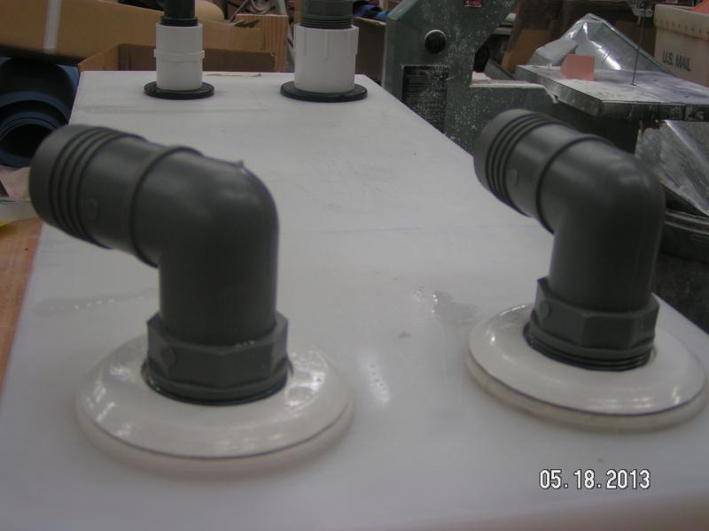

I recently reconfigured my waste holding tank and related plumbing on my 1976 Pearson 365. I was able to fit a 20 gal standard plastic tank without modifying existing locker, other than to glass in a mounting base. I used two dip-tubes for discharge to eliminate any Y-valve issues. One dip-tube for the deck pump-out and one for overboard discharge. I incorporated a Whale manual pump for the overboard discharge to keep things simple. I used the Sealand Dip Tube kit, but you can make up your own using PVC pipe and "Uniseal" slip fittings or "Press Fit Sealing Grommets" available thru McMaster-Carr industrial supply. Also increased vent to 1" Went with a SCAD-SOLO Tank Monitor with external sensor to monitor tank level - have yet to install the monitor so can't report performance of the guage yet. All fittings located at top of tank.

We, like bio whatever have 2 top entry "dip tubes" and no y valve
they leave about 2" of stuff In the tank,cutting our 20 gallon tank to about 18 useable gallons. On the other Hand the tubing is dry and when there will be a problem all
The plumbing will be accessible

ybrad, I used a 1" thru-hull for the vent, per Peggy Hall's reccommendation. Enlarged the existing vent hole to accommodate the larger fitting. http://www.wakemakers.com/90-degree-composite-thru-hull.html located just below the toerail. Used existing 3/4" thru-hull for the raw water intake and existing 1.5" thru-hull for the direct discharge . So far, we're using fresh water from the shower head to flush, to help keep things "fresh".
