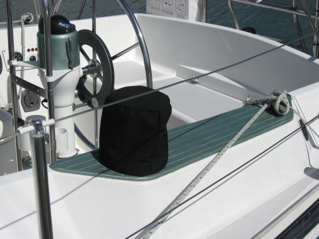

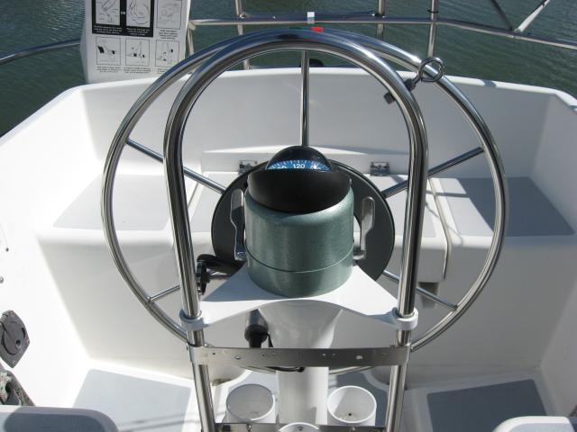

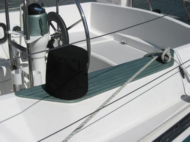

Here's a couple of pic of my pedestal/binacle. The shift and compass housing is brush painted with the Hammered product (a mix of green, silver and a touch of gold).
The base/cylinder sections of my pedestal had scratches down into the aluminum when I bought the boat ... but not too many. Otherwise the (original) paint was in very good shape. I just carefully touched up the scratches with the same white paint (Interlux Perfection) that I used for my repaint of the cabin top. The color was a good match and I don't even notice.
The flat white cast aluminum piece that connects the pedestal to the guard rail was in very bad cosmetic condition. So this also was repainted with Interlux Perfection. But I did use an epoxy primer on this first. So far its been staying nice looking.

It was a custom mix of Hammerite colors. I had silver from other projects. To get my outcome, I bought a can of Hammered green. I knew the green was too dark for my envisioned result, so I first mixed it with the silver to tone it down and get a more "mist" green. On the first coat test area, it still seemed a little too dark green and it seemed to have a blueish hue to it for my liking anyway. So finally, I put it more silver to lighten further and also a touch of Hammerite gold (which I also had on hand from another project) which took care of the blue. Each can of the (Hammerite) stuff runs about $12-15 depending where purchased. So if you don't have the colors on hand, duplicating my color would get pretty expensive! As to maybe mixing standard enamels (say you had some green Rustoleum on hand), the chemistry is different and I would expect that the non-metallic component might make the end result non-metallic.
