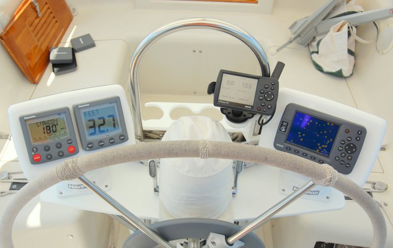

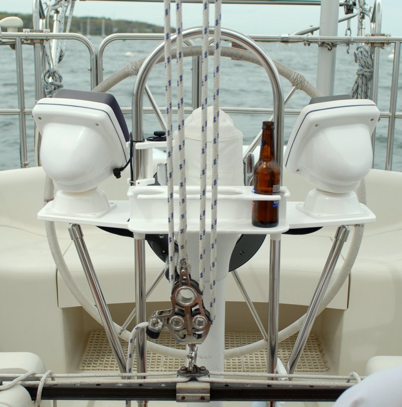

I used
I used 3/4" Starboard but it still needed support struts. This shelf replaced my pedestal guard top plate and holds two identical NavPods one for the plotter/radar and one for Depth & Autopilot.
