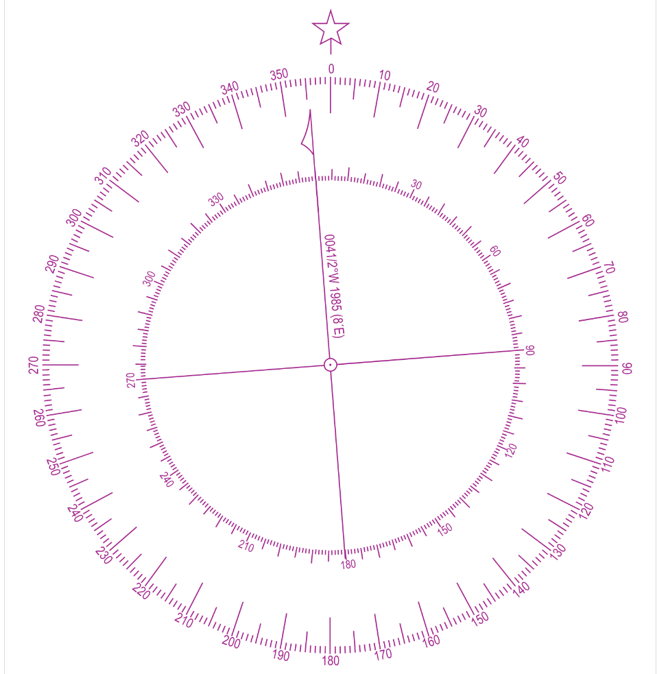

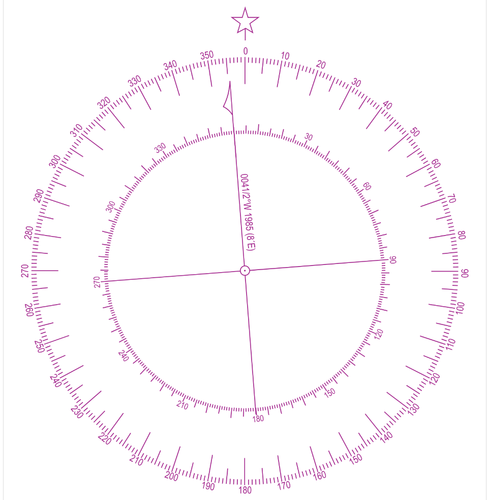

Anyone WITHOUT paper charts know what this is and what it means on a paper chart ?
I thought so.
13,005
Or invest in a few paper CHS charts to see what's going on. These are almost unheard of in our marina.
"Why bother when I got this handy, dandy pocket GPS in my back pocket"
And that's why CHS repeatedly brings up the subject of PRINT ON DEMAND ONLY where no vendor stocks charts anymore.
I thought so.
That’s easy it’s a compas rose.
