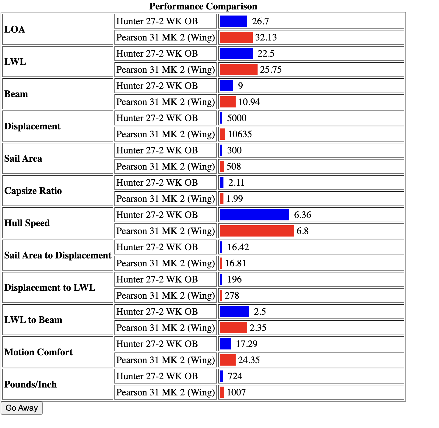

Here's a chart, to give an estimation of difference between your Hunter & the Pearson. Assuming I'm correct in the boats involved.
The 31 is 2' wider, about 1/2 knot more hull speed, similar Sail area to displacement, and a bit more comfort @ sea.
