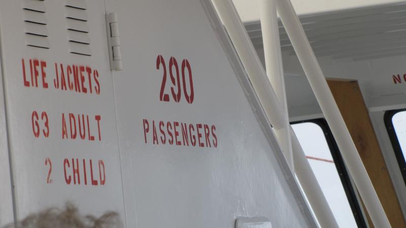

This is one of my favorites as to how many people should be aboard - from a commercial boat at Grand Cayman Isle
