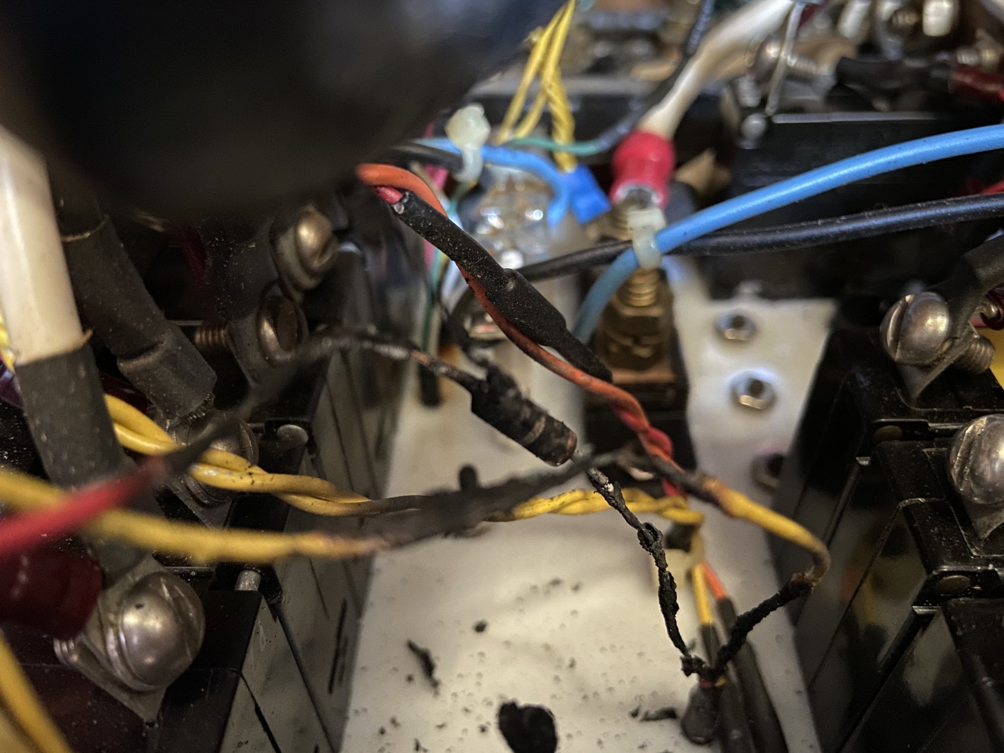

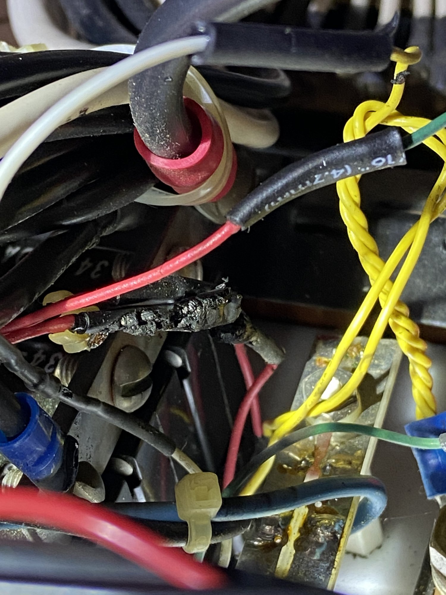

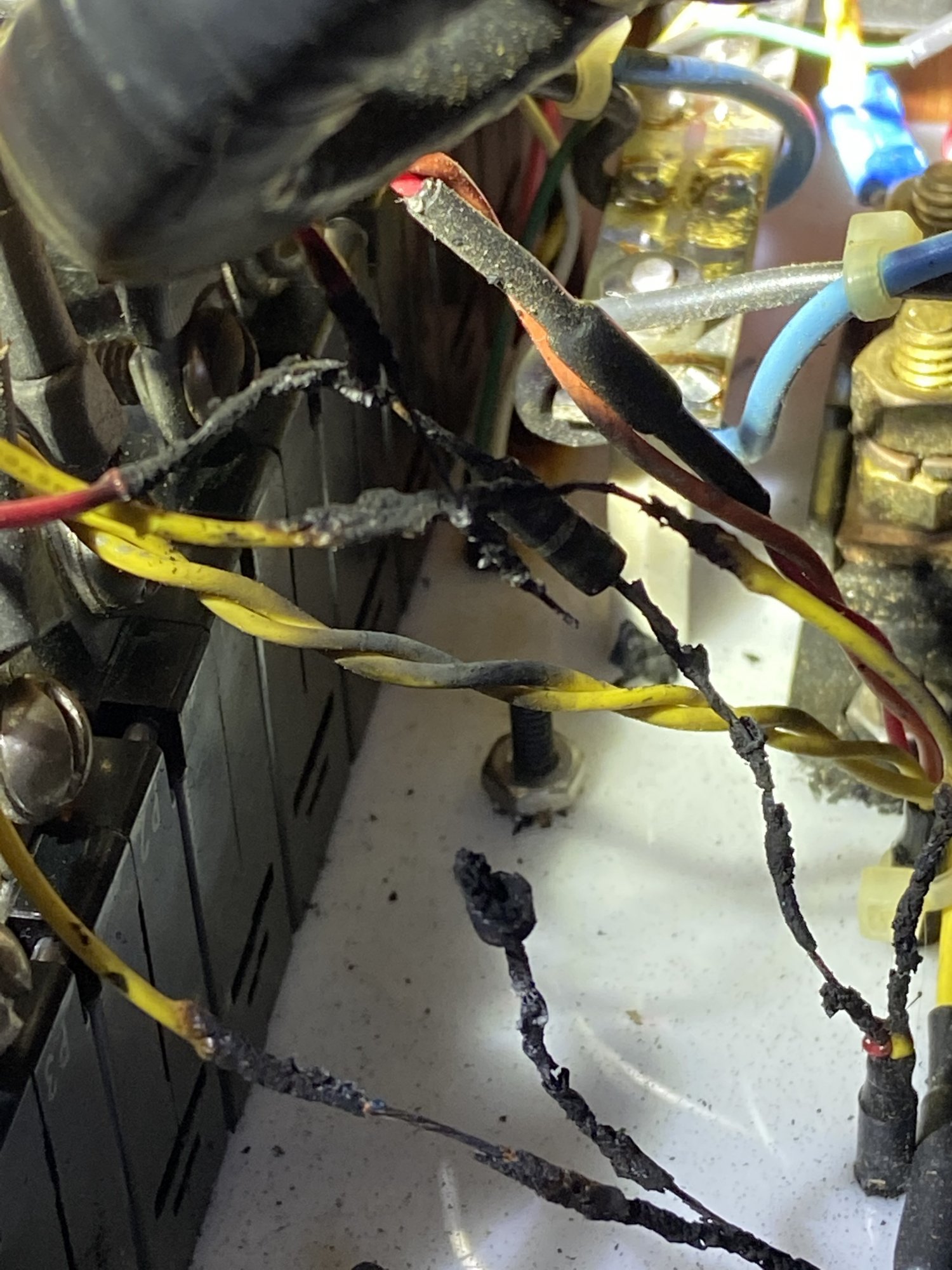

Anyone have a thought as to what may have caused this? I am not finding any other electrical issues. Various circuits working. Only noticed this as I was starting to trace wires to the hot water heater - not heating using electric. Other breakers from this panel are working fine.

Burnt wires is not a good sign.
You need to find out what happened.
Jim...
PS: Looks like a Resistor exploded too.

To me, from the pics, it looks like your 12 V source (1 or more batteries) shorted to ground, the yellow wire......this is very serious...

Yes two of them
agree on serious. All the wires in the pics are tied to the main 110V line source. Except for black / white that goes to air conditioners when generator running.
You’re lucky you still have a boat. But a lottery ticket dude. These connections just smoulder until you decide to leave the boat for a few hours
Check your shore power cables for burn marks.
Wild guess...
Shore lightning strike near the marina's main power meters ... ground wire.
Feed back surge on the 110 Volt system to your boat.
Jim...
PS: This happened to our boat. Had to replace all breakers in that AC circuit, etc. $800.

Its hard to tell from the photos, but THESE DO NOT SEEM TO BE AC LEVEL wires/components! All AC wiring should be 14/2 etc. covered wires with a ground. One photo seems to have a resistor in it which seems designed for low voltage DC circuits. If these wires are tied to your AC circuits then someone has been playing with fire. I agree get a certified marine electrician asap!
But, your DC circuits can easily burn up wires if shorted. If these are going to your water heater, they maybe 12 v DC temp sensors? Our water heater can run on shore power or engine cooling water, but not a 12 volt system.

If you are quoting from a previous answer, all bets are off. There's your major problem right there.
This board is "as is" from the manufacture.
What you show in your photos is someone's home made mess. This would be the PO I presume. The person who did that didn't know a wire from a halyard. And you're showing your complete lack of electrical knowledge by insisting that it's "as is" from Hunter. Hunter did not put out crap like that at any period. Forget your lack of electrical knowledge ............. admit it and get over it. You've got plenty of other boating strengths elsewhere, I'm sure.
Forget the lightning theory and other stories. You've got an electrical wiring mess in your boat that nothing to do with lightning. PERIOD.

In your third picture, 8906, there is a red wire connected to a green wire. I find it difficult, if not impossible, to believe that ANY panel manufacturer would have produced this product with this color mismatch. I believe you have simply been very lucky so far.
