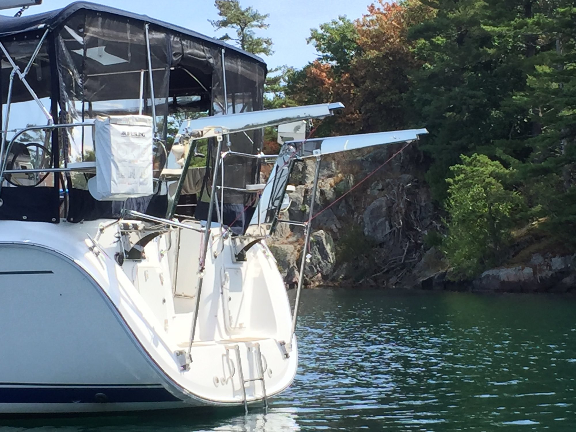

I have a very good solution
On my 49, I was looking for some best stylish, and strong Davits.all of the tube davits were very wobbly, and looked like cheap add-ons.
You can actually sit in my dinghy when it’s hoisted, c/w having the engine mounted.
So, it’s not an inexpensive solution, but it will work perfectly. And with a center cockpit boat, it will integrate well with the aft cockpit
