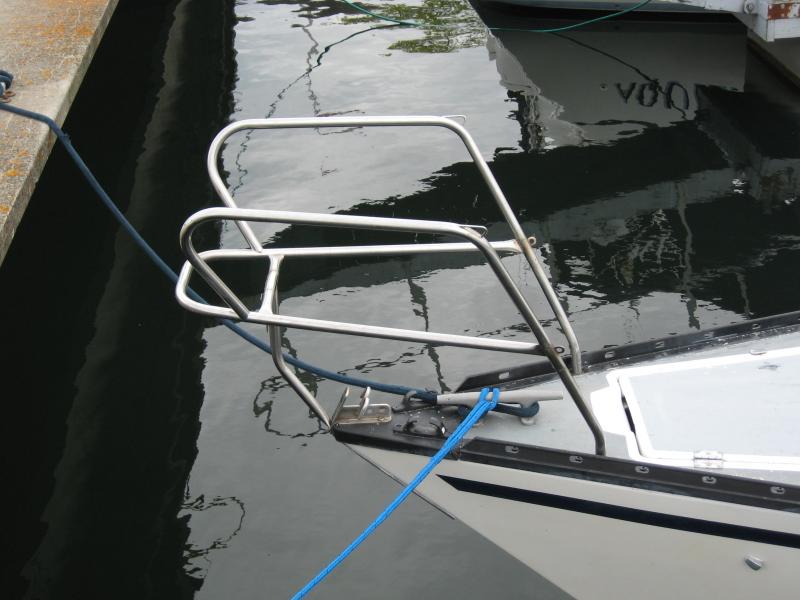

I have a 1977 Cherubini Hunter 30 and it has a bad bend in the bow pulpit and needs to be replaced. I live in N.J. Does anyone know where to buy parts for for this type boat? Or is there a welder that can make a pulpit?
Thanks guy's but I found a bow pulpit from another club member. Tall Oaks Yacht club had a get together and after talking to some members one of them had a similar one that will look great in perfect condition.
