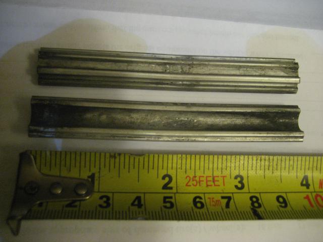

Princess, is this what you are talking about? The split connectors? How much is a boat unit?
I was told by the folks at Reefer that you can use half of the connectors to bridge the gap and connect the foils. The recommended a set screw or rivet to hold in it place.
I am considering just welding two foils together to eliminate the connectors that are broken.
