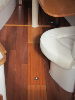

I'm certainly no expert but I prefer to drill and countersink before finishing, sink them deep enough to allow for the varnish. Mine were bad and while waiting for a $300 piece of teak and holly veneer plywood to arrive I thought I'd make up a quick set of temporary soles from oak. I kinda liked the result and they're tough as nails, so I've left as is for now.
