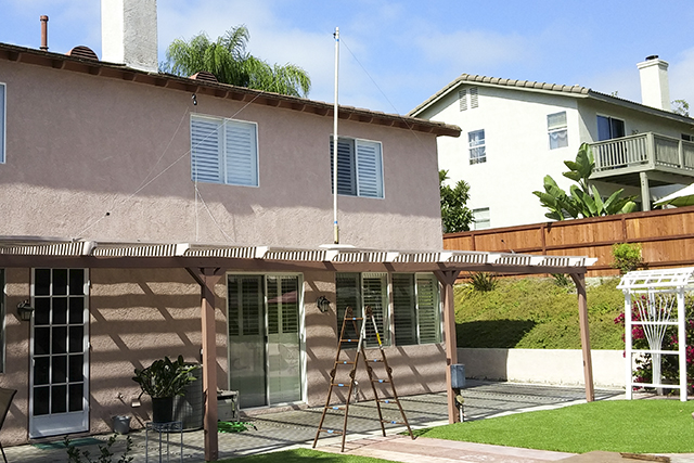

Well the vertical didn't work and was blown over by the wind. Plan C also crashed even before going up. The pole was top heavy and no matter what I did I could not get it stable enough to even attempt to see if it would work. Need a sturdy mast to support an inverted V.

Plan C reinstated. On one of my walks around the neighborhood I fell upon a lonely 1-1/4 PVC pipe that was 11' in length. Not seeing anyone around I felt it my duty to clean up the place. Back at the house I have an unused patio umbrella stand. Put the two together and now I hear signals I don't normally hear in the morning. We'll see how this works.
Apex is about 19 feet so that is almost .3 Wavelength. Hopefully this afternoon will give me better signals. Even though the band is wishy-washy. With the tuner I can tune other bands but efficiency is questionable.
