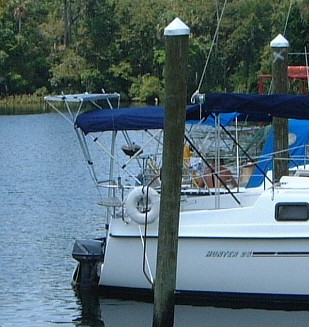

Lynn,Here's my setup. The Unisolar 32 flexible panel is supported by an aluminum frame 18" by 8 feet, mounted on two 7/8" aluminum poles bracketed to the bimini support legs. The brackets are standard bimini hardware. I wish I had a better picture. The wire goes down to the sternrail seat and into the gas tank well. It passes thru the bulkhead by way of the hole for the motor leads. I have a 105 ah AGM battery and a solar panel regulator to prevent overcharging.
