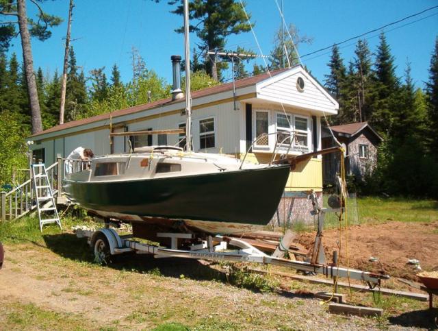

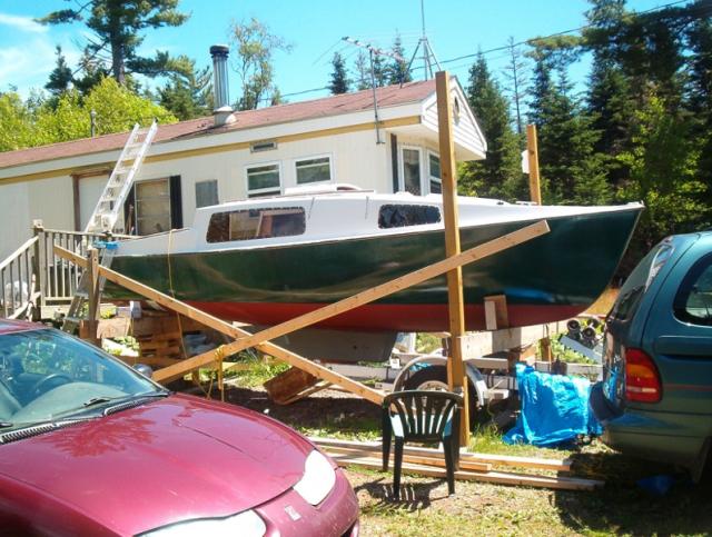

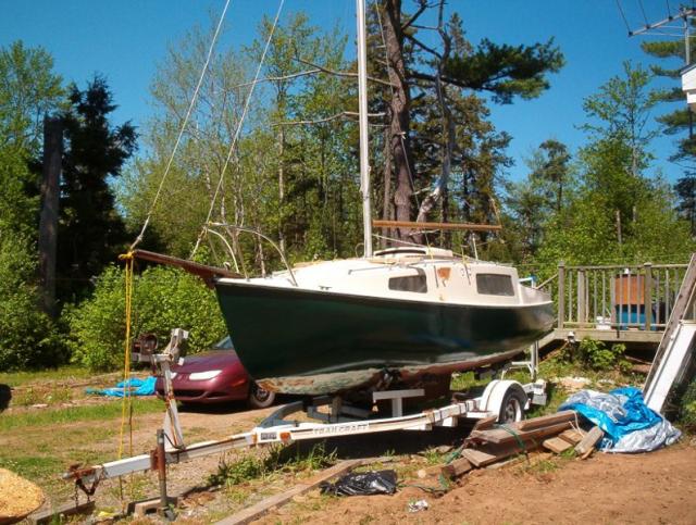

Hiee,
I have totally repainted my boat which is a shade under 22' actually about 21' 10'' LOA. I used the better part of a gallon of Pettit primer from the waterline up and did not do the cockpit. I bought 4 quarts of Brightside and returned one of them and still have enough left of the third to do a forth coat. I used Pettit Easypoxy for the cabin and decks. I still have a bit less then half a gallon of that to finish off the cockpit and perhaps inside the cabin.
I would NOT recomment the foam roller for either of the polyurathanes as it seemed to leave many many tiny bubbles much more so then the close knap roller ie 1/4''. Tipping was relatively easy although I did end up with a matte finish which I can personally live with.
Happy sailing,
Brina
