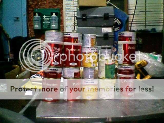

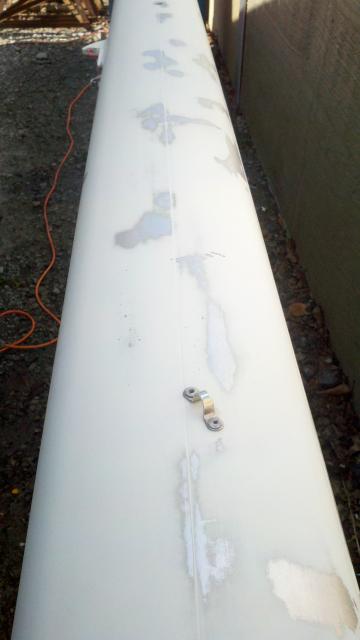

After many successful years of brushing on one-parts like Brightside and Toplac I decided to heed your advice. Everyone seems to get amazing results with two-part epoxy paints like Perfection. So I bit the bullet and bought a quart of epoxy primer and a quart of Perfection.

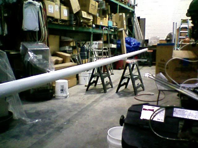

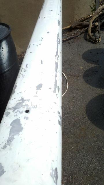

My first coat of the primer on the small staysail boom was a disaster. It was too thick and seemed to set before I was half done. More thinner(2333 I think) and the second coat was better but still required a lot of sanding.
Now I am thinking I might just cover with a one-part and sell the $50. quart of Perfection. And do you use a new $15. brush every coat? What cleans a brush with an epoxy paint?
