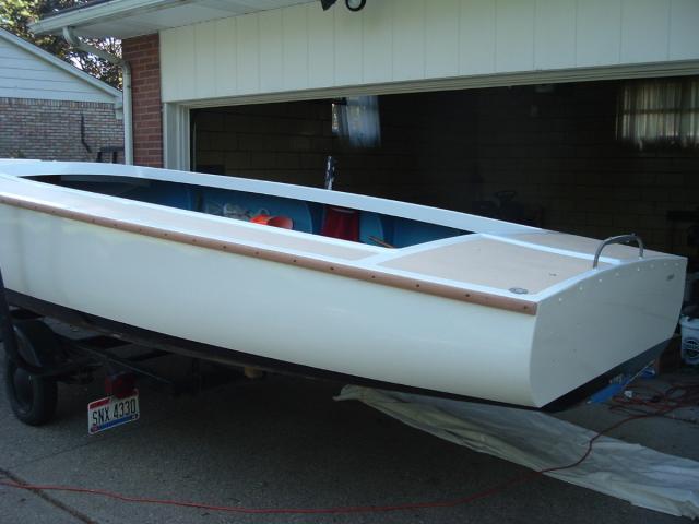

I used Brightsides for my 1955 Rhodes 18 restoration a couple of years ago. It went on fairly easily after a long time prepping. It looked good but it did not hold up very well. Perfection(I used on my Ericson 35 spars) is much tougher and in hindsight should have used that on the Rhodes.
