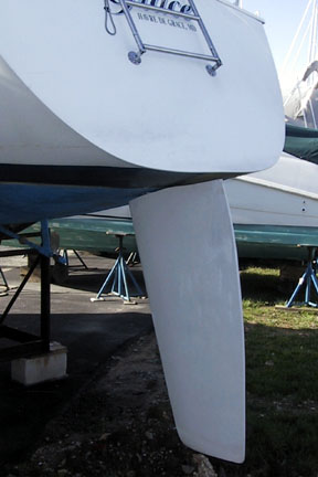

White after re-build
Warren, I just pulled my 1987, 285 out for the winter and if you look at the attached photo you can see that the rudder is also white. I painted it after I re-built it last winter to correct a lot of delamination. I also read that it was a good idea to paint it white and hey, it can't hurt.

White after re-build (with photo this time!)
