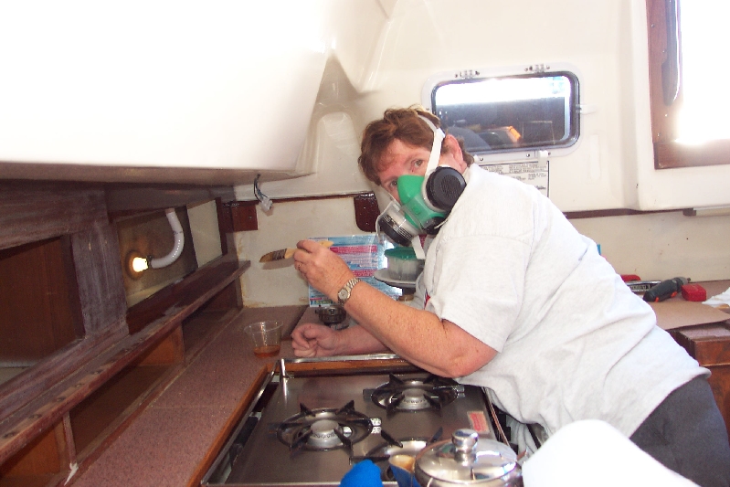

We found that getting masks with an activated charcoal filter is well worth while, it will save you the awful headache that comes with sniffing paint fumes, which seems to happen no matter how well ventilated. Also as noted above, the hazard is on a par with filling the boat with propane.
