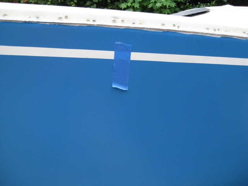

Blue primer. Really it's not a bad color, but my wife isn't a fan.

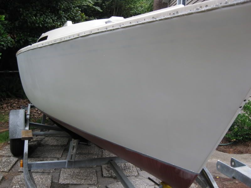

2nd coat of white primer on the other side. After sanding, I'll slap on a coat of the blue primer
If you didn't believe me about the color matching the masking tape.

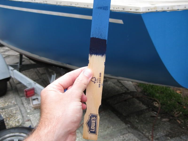

Darker blue is the color the boat is going to be.

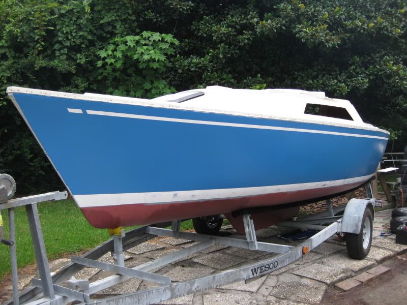

I ended up making the stripe between the 2 existing stripes so it's a little wider. I would have gone with the thinner stripe, but it seemed a little too low. I'm planning on getting some pinstriping tape to accent it a little. Probably red to stick with my color scheme.

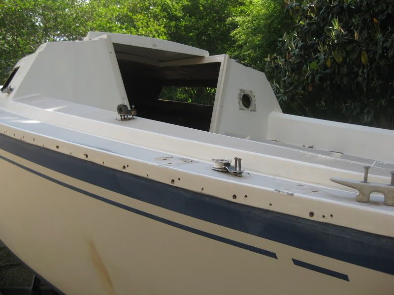

Do you have any leaking in the interior? I rebedded my windows, but still had a leak on the port side. The rubrail had been replaced several times, and the holes were not filled. I see where yours are. I removed the screws and recaulked the joint, then filled the holes before reistalling the rubrail. Not sure where the problem was, but it's gone now.

The bottom picture is an old one before I fixed up the hull joint. I've already filled all the holes with epoxy, used my dremel multimax to cut the excess off, and filled the joint with roof type polyurethane white caulk. I slapped a coat of paint on this weekend with poor results. I tested the paint inside the garage on a piece of glass and it settled out perfectly, went out and painted it on a hull that was too hot and it looked like I painted it with one swipe of a brush. That's what I get for getting too anxious to put paint on. The weather ended up being perfect a couple hours later. So, now I have to sand the paint pretty aggressively. I do have to say the paint feels great! And from 10 feet away looks awesome. The topcoat paint is definitely a different animal from the primer so don't think that if you did a good job with the primer that you can use the same technique on the topcoat!
