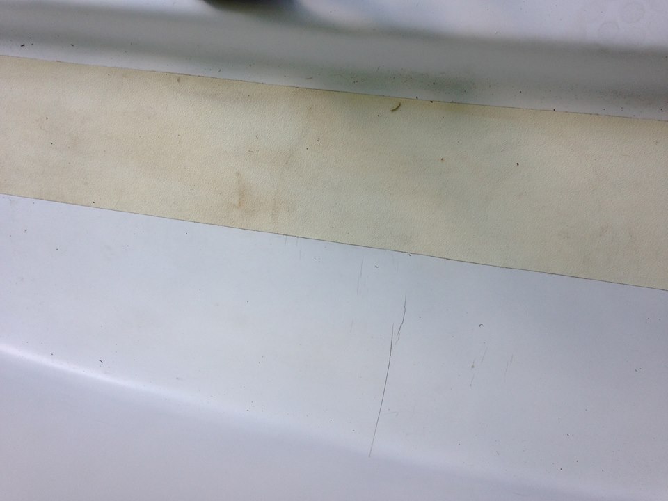

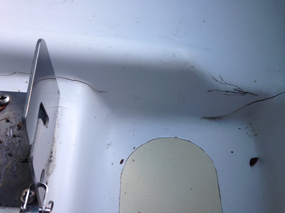

Serene
Oct 2, 2016
5
Hunter 17 OH
I am most concerned about the crack in the 2nd picture it seems to be the most severe. The first picture is the smallest crack but there is just a little give under the floor and I am just not sure if that is normal or not. I think picture 3 will be simple to repair. There is a just a little delamination in the bow floor but no cracks so not sure I should worry about it. Thanks for any advice.

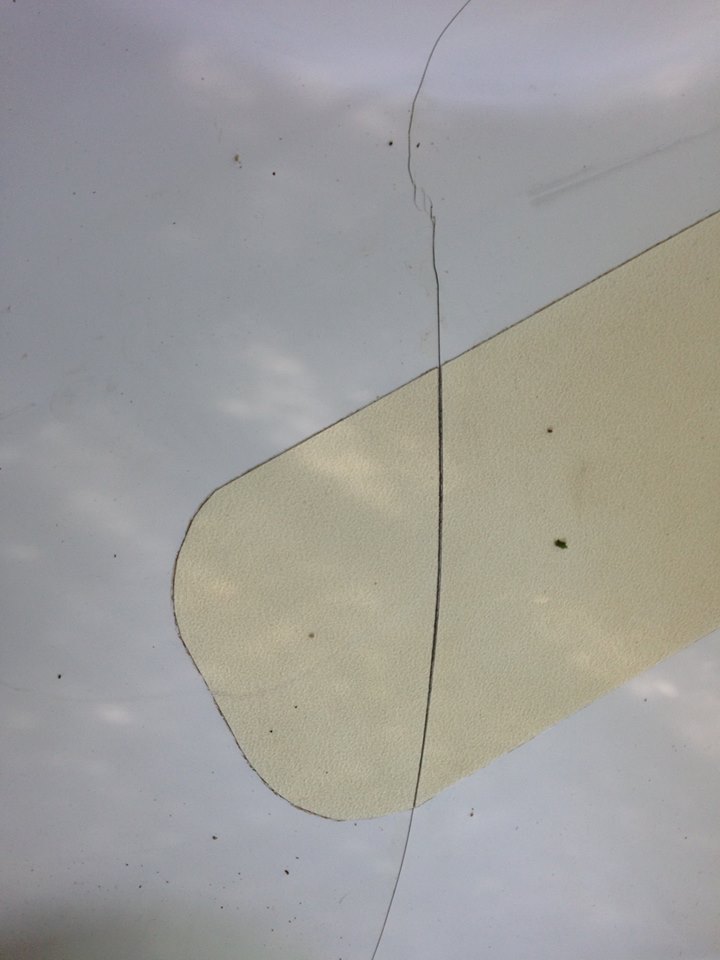

Serene
Oct 2, 2016
5
Hunter 17 OH
I removed the non-skid tape on the deck and you can see how a few of the cracks flex as you walk so I feel like there needs to be some reinforcement on top or underneath.
