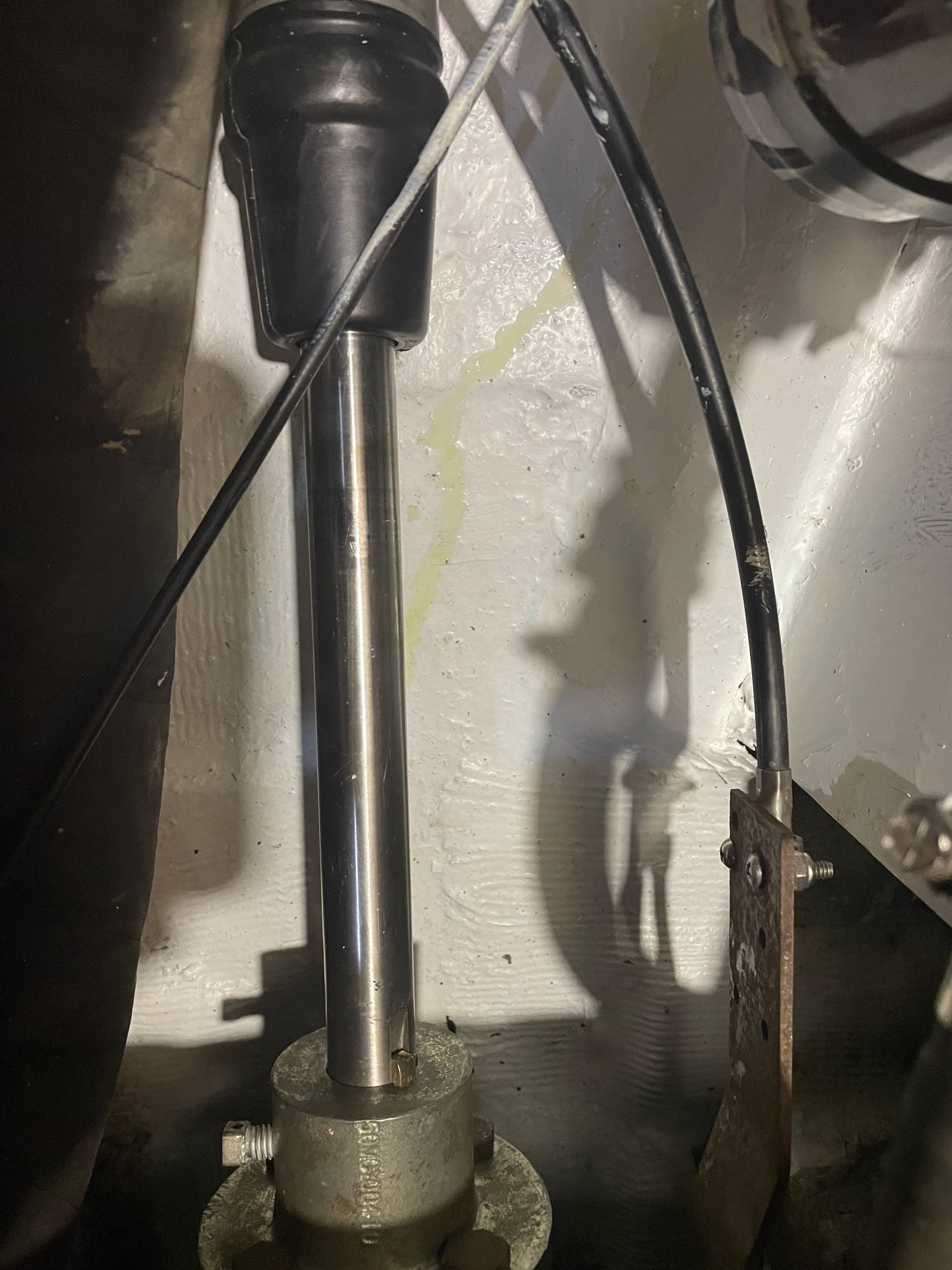

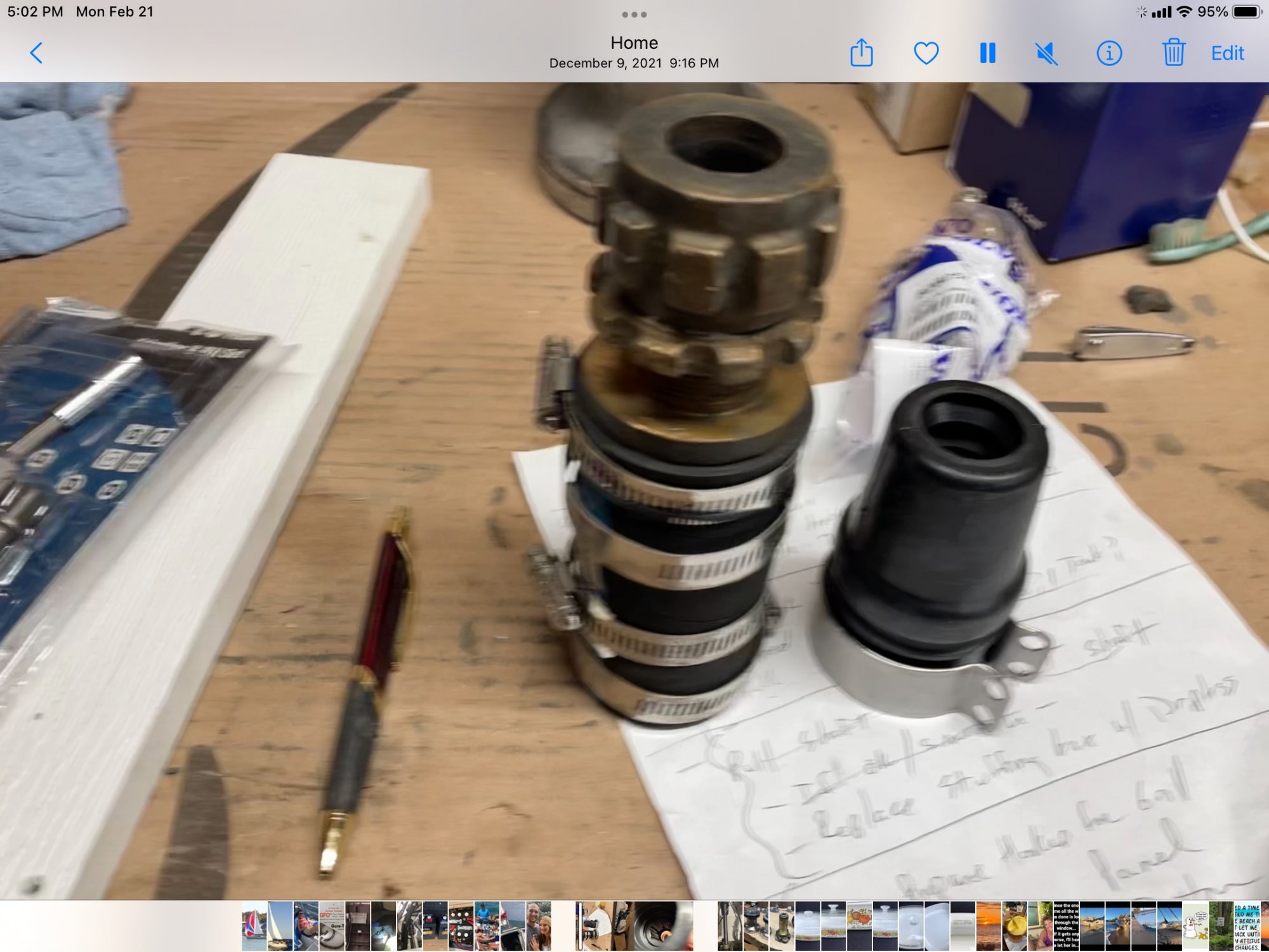

My “standard” stuffing box would run pretty warm…I used an infrared thermometer to check it. I don’t remember what the temp was, but it was warm if not hot to the touch. I used both regular waxed flax (I didn’t care for that) and teflon-impregnated GFO packing. I liked the GFO better and could almost run it dripless (but it did run warm).
I replaced it with a Volvo dripless rubber shaft log. Very simple design and so far (first season with it), I am a big fan. No drips, bilge is dry, and it runs cool.
it also saved a lot of space in the bilge behind the engine…
