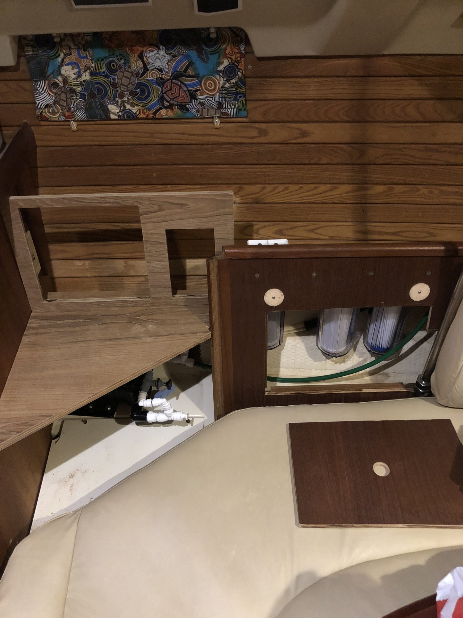

We installed a CruiseRO 30gph unit in our ‘90 P42. We installed the high pressure pump in front of the water heater and the membranes infront of the high pressure pump. This took up a fair bit of space under the port settee but it allowed for relatively easy service of the system while still allowing storage of smaller items around the membrane housings. The pre-filters are installed behind the port settee seat back aft of the rigging strut. I cut access panels in the seat backs for easy access to the filters and boost pump. The control panels were installed in a box I built from teak veneered plywood in the space occupied by the wine bottle storage provided by the Hunter factory. The boost pump is located beneath the control panels.

Neffilicious - beautiful install! I didn't realize there was so much space behind the seatee backs. Sounds like you have a self priming boost pump. Did you install a new thru-hull or leverage an existing? If I go ahead with a WM, I'm thinking of converting the heads over to fresh water flush and would leverage the aft head thru hull. Thanks for the pictures and idea of leveraging the liquor storage area.

Jim_H42 - thank you. I put a bit of time measuring available space in different places while trying to keep hose runs as short as possible. Also a priority was easy access to the control panels whole making their install look like it might have been a factory option, or as close as I was able with limited wood working skills and tools.
The boost pump is self priming. It’s a Jabsco diaphragm pump without a pressure switch so there’s no risk of it cycling in use. I used the aircon inlet through hull for my seawater source. I originally fitted a Y-valve but after we started cruising I fully decommissioned both AC units (removed the forward entirely) and now the WM has that through hull as it’s own.
