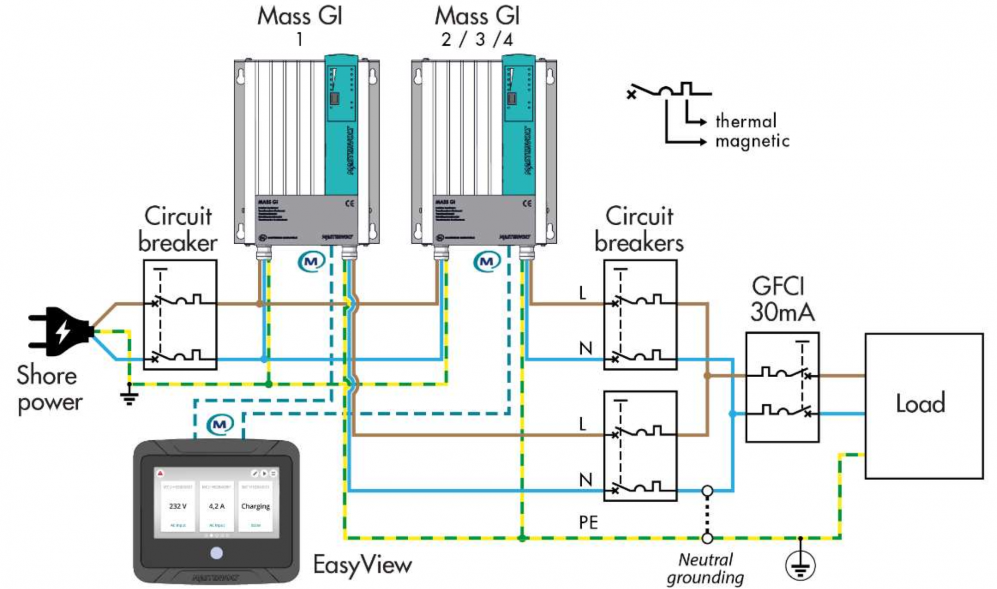

I keep wondering if the problem lies with the neutrals and ground. The ground and neutral should be bonded at the source of the power in an AC system. Shore power AC is bonded at the main power panel, generator power is bonded at the generator, and inverter at the inverter. When only one energy source is used, then it works, however when 2 different energy sources are involved, inverter and shore power for example, the circuit isn't really in parallel because the neutrals are separate.
Here's a wiring diagram of 2 Isolation Transformers (Mastervolt Mass GI) jwired in parallel. Note that all the neutrals and grounds are tied together and return through the shore power connection. As a result the load is drawn evenly from both sources. I'm flying at the edge of my knowledge here and am struggling for a good explanation, yet I think the problem lies in the neutral. If we parallel batteries both the + and - posts are connected, there is a continuous path for the electrons. If only the + are connected to a bus bar and the negatives are completely isolated from each other, then the circuits aren't complete and there is no power. There's a good chance that this explanation is incorrect, still I think that's were the problem lies.
