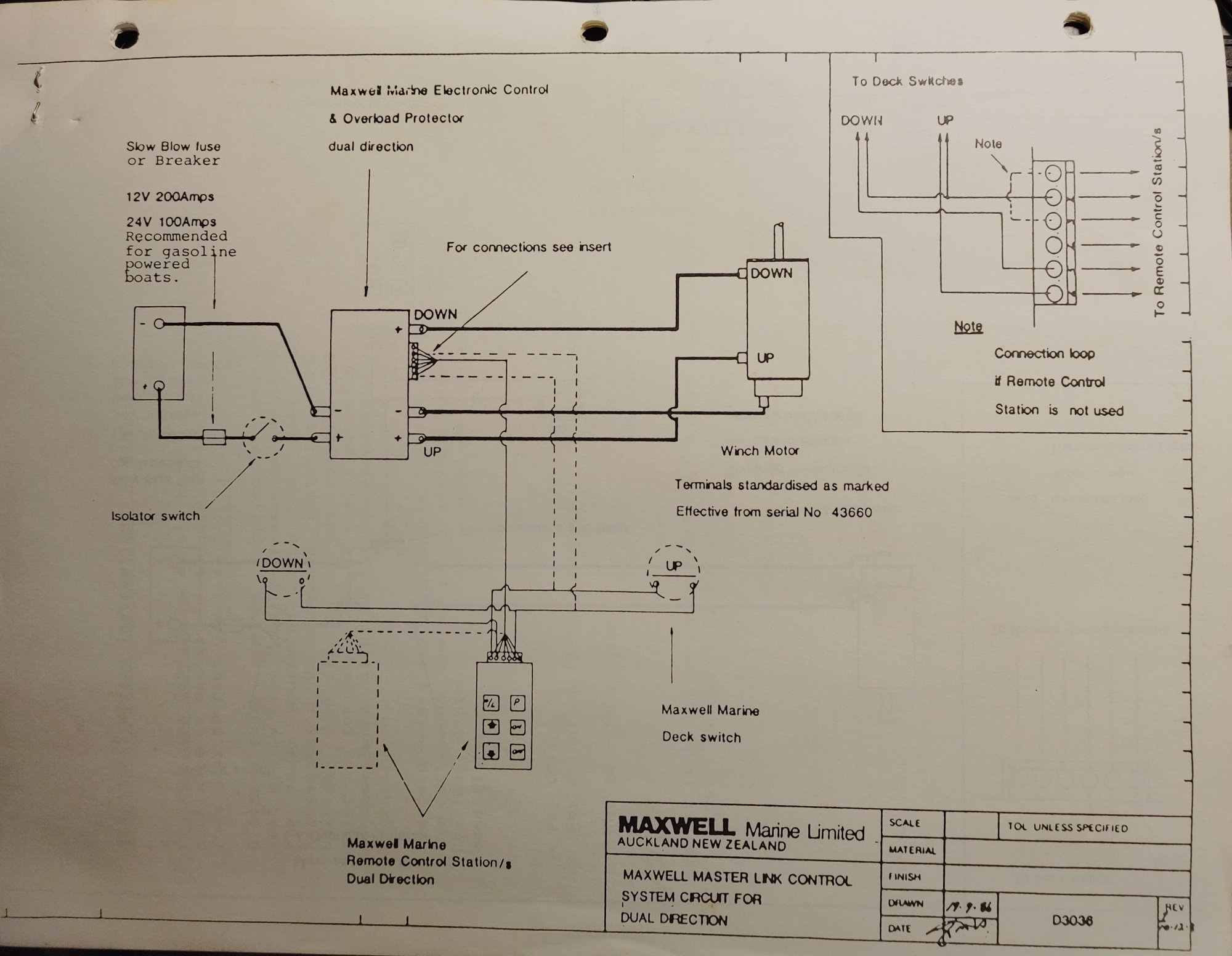

For reference, I've include pictures of some of the related wiring from my Hunter Owners Manual.Maxwell Wiring1.jpgMaxwell Wiring2.jpg
I've done one modification to add a Wireless Winch Remote Control Kit. Since it's handheld I can easily watch over the bow as the anchor is raised. It was quite inexpensive from amazon and has worked well for 2 years. Since I didn't have a lot of faith in the handheld, I did wire it up so the windlass so it will work with either the wireless remote of the foot switch .
This is the wireless unit:
In looking at my windlass motor, I'm pretty sure that it could be made to also lower the anchor. Although I haven't done this project yet I believe this could be accomplished with Reversing Polarity DC Contactor such as this one:
