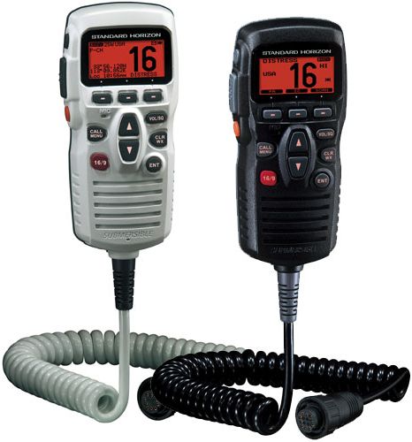

Vhave you considered a VHF with a RAM3 remote?
23,392
I installed the Ram3+ mike last spring and it has been excellent. Need to remember to turn off the system prior to plugging in or removing so you do not error and jam a pin in the wrong connection. IT IS NOT PLUG AND PLAY. You have full control of the VHF. The mike and speaker are in your hand. AIS is provided.
In stall was easy. Locate where you want the mike and cord to hang. Drill holes for the fitting and screws. Clip the ferrite core not he cable behind the mike fitting. Route the cable (I think it is about 15 feet long). It was plenty long enough to go from the aft portion of my cockpit to the radio in cabin with cable to spare. Connect to the radio. Done. Turn on and enjoy vhf communication in the cockpit.

Are looking to install another complete VHF or a remote, full function mike (like the RAM+ unit above)?
What is the VHF unit that you have at the Nav Station?
Jan 18, 2016
782
Catalina 387 Dana Point
I have the Ram3 mike and I really like it. I also have a small handheld VHF with gps. I actually use the handheld more than the Ram3. The Ram3 does display all the same AIS data as the VHF below, and that's very handy.
