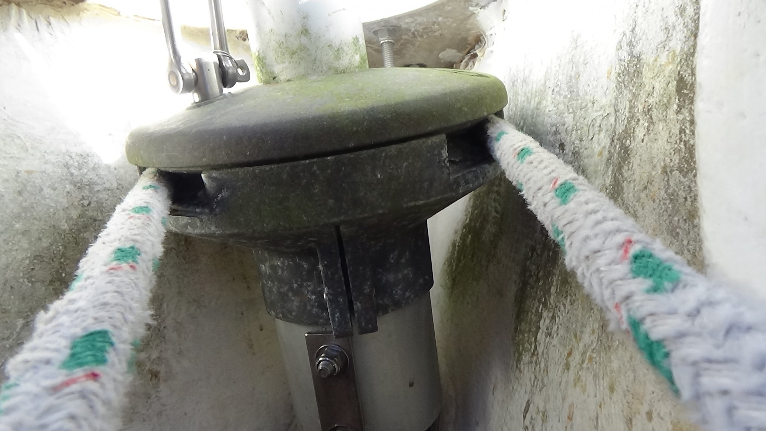

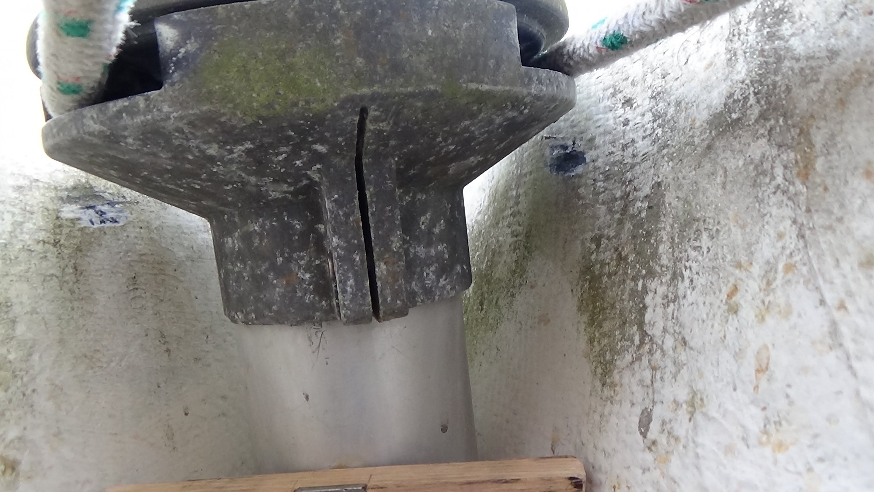

Our 1991 boat came equipped with a Hood double line furling system that has always worked, except recently while on a cruise with my oldest son and his family. In the picture below is a temporary modification using a piece of wood that is bolted to the aluminum cylinder base of the Hood drum. The purpose was to keep the drum from rotating thus causing the double lines to bind at the point of drum entry. The original "U" bolt that secures the cylinder to the horizontal SS pin that is part of the head sail chain plate was insufficient to keep the drum from rotating.

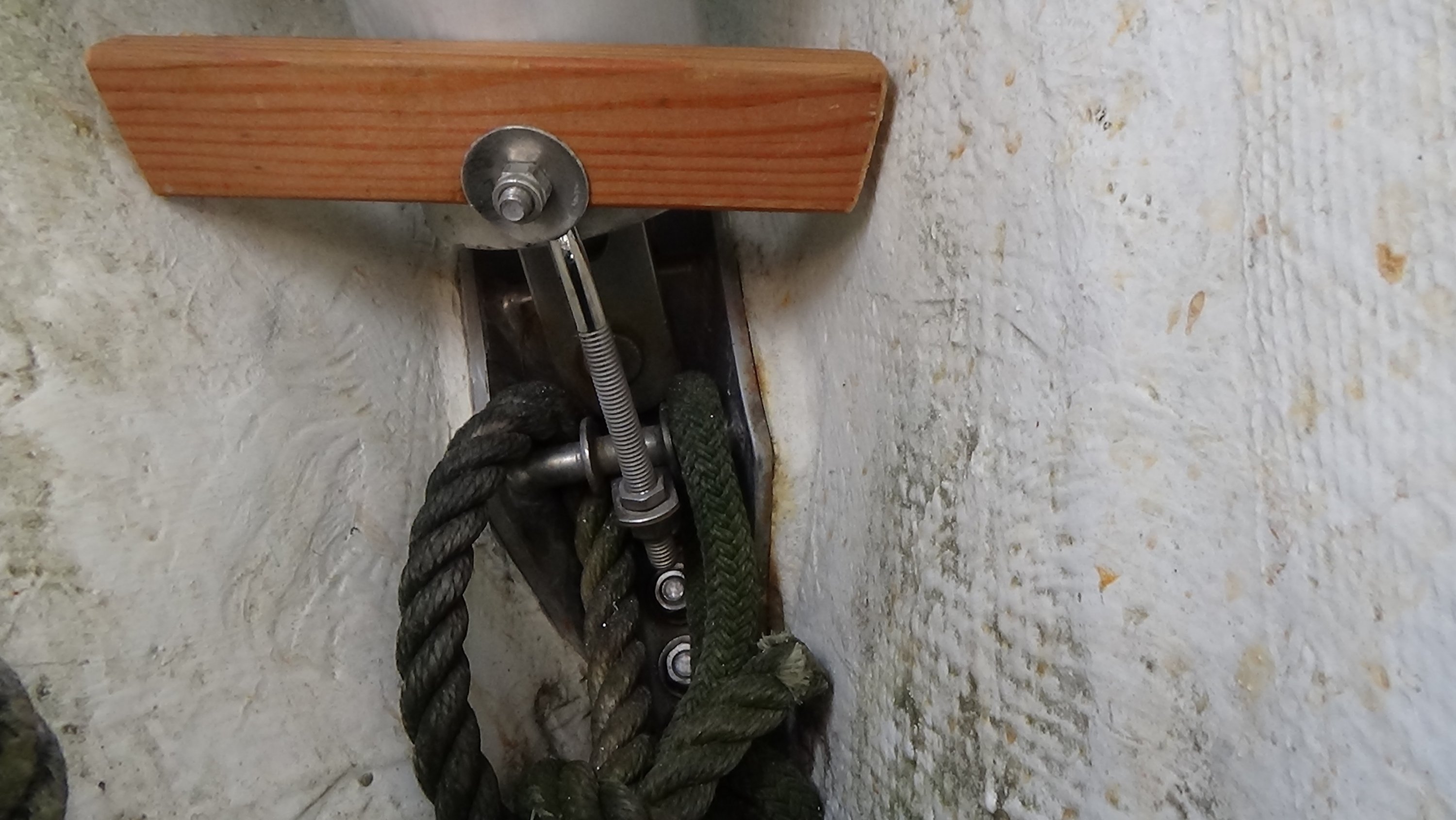

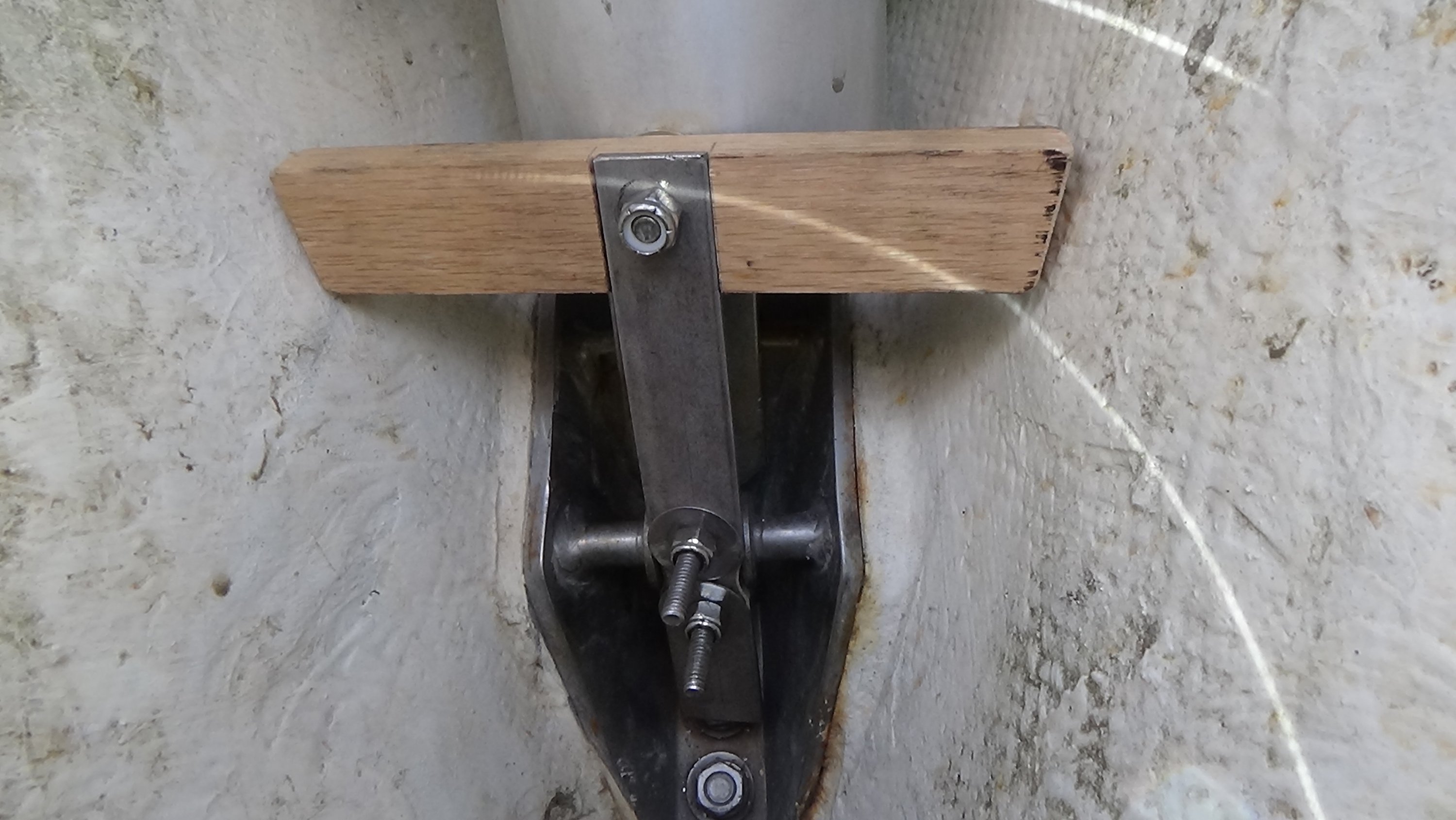

So, in the picture below, to create a more permanent fixture, I used a piece of SS bar to replace the "U" bolt and a piece of oak to help keep the drum from rotating as it did before. What I may do is to fabricate a SS bar that has two bolts that attach to the aluminum cylinder. That might work just as well, thus making the piece of oak unnecessary.

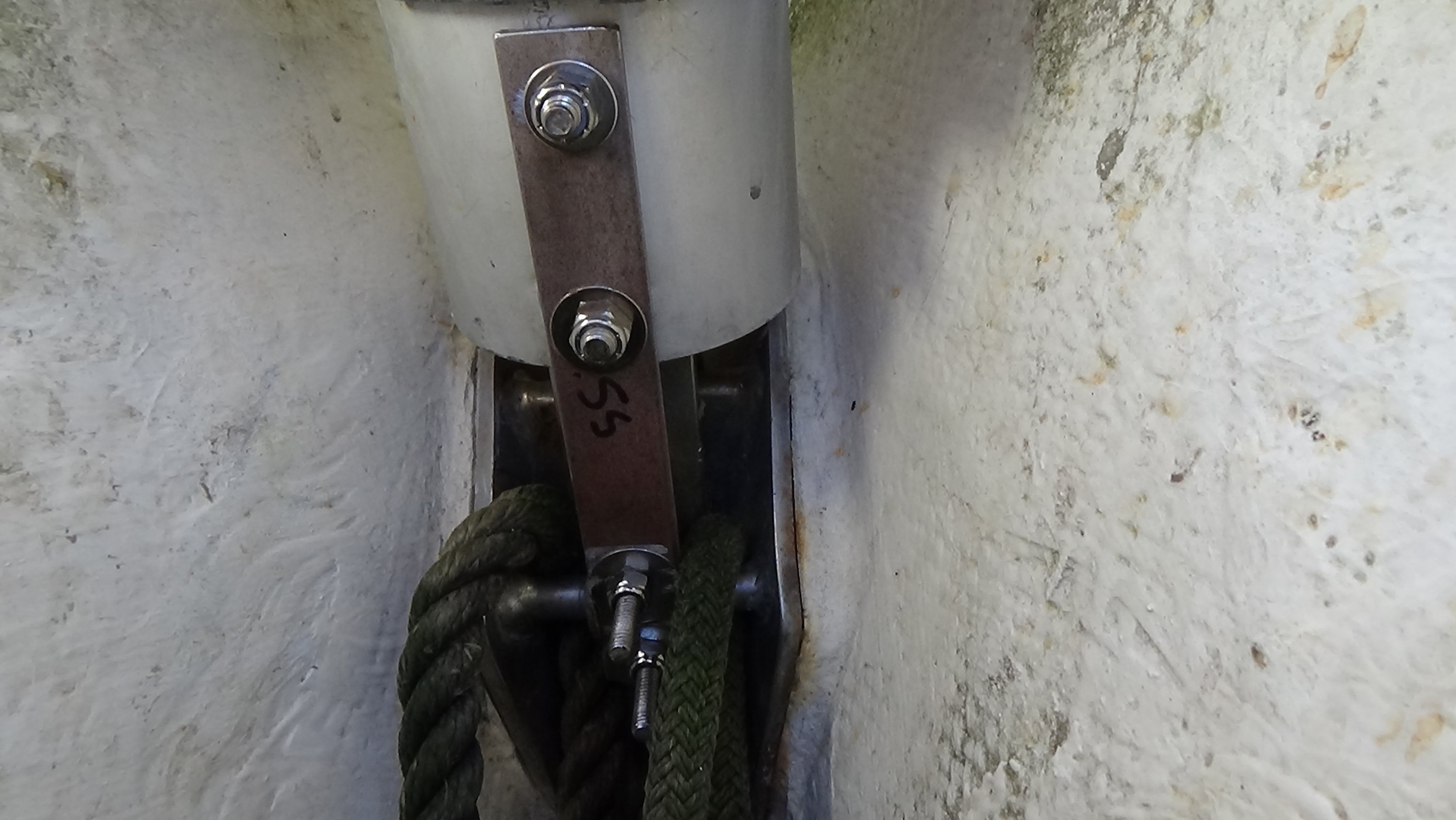

I got the bar idea while cruising the docks at Friday Harbor where I saw an older H43 with an original Hood double line furling system that used a SS bar to secure the Hood drum to the chain plate. Made more sense to me than a "U" bolt. Now a sea trial is in order to test the modification.
