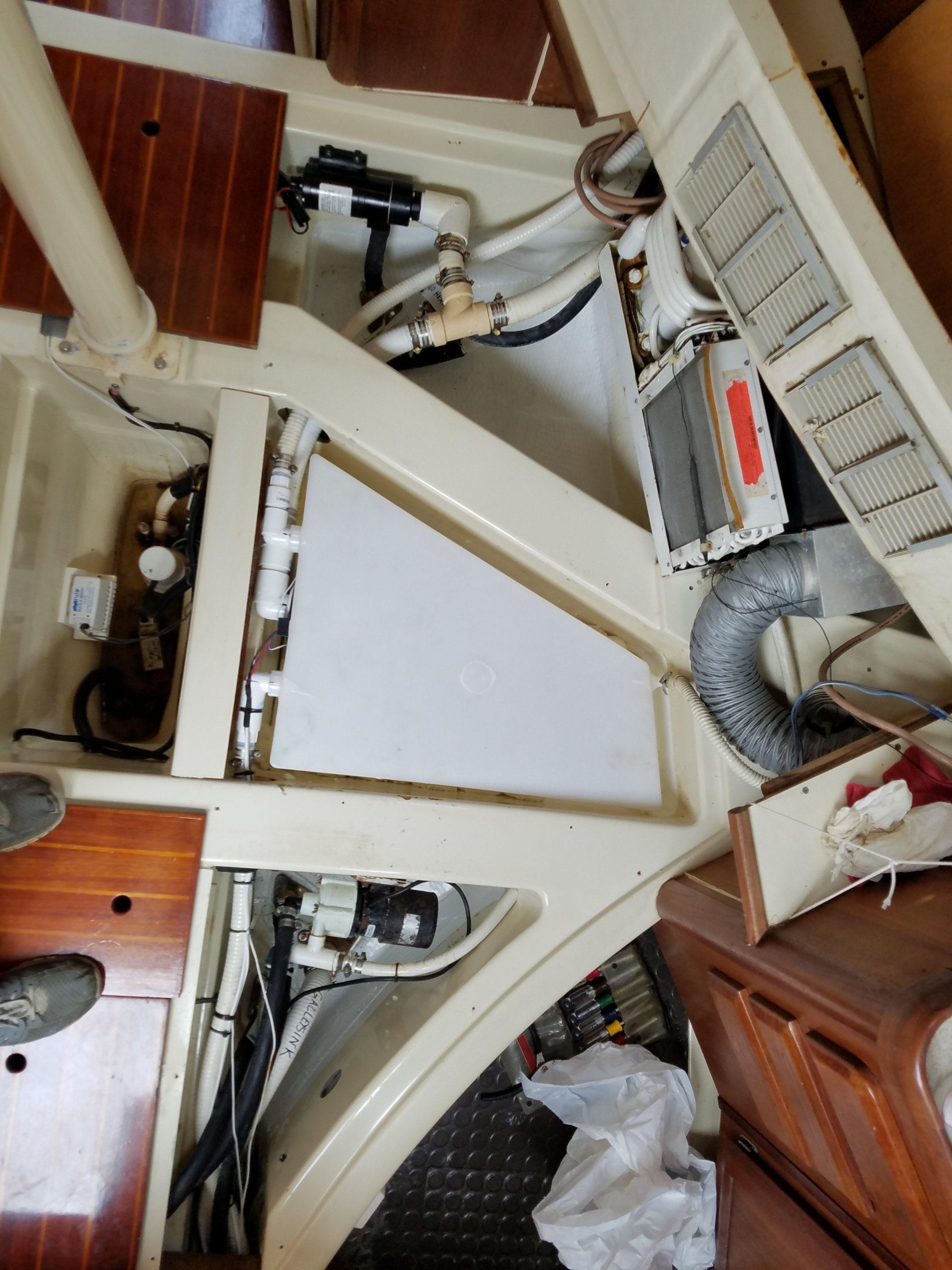

I've attached a pic of the new holding tank. Between the aft head fill hose and the center pump out hose is the fluid sensor level attachment and the wiring.
My previous boat was 'stick built' interior - it didn't have a pan. I'm learning the Hunter Factory (and owners on this site) have some creative ways of getting wire and piping all around the boat. It all makes sense in hindsight. Thanks for the help.
