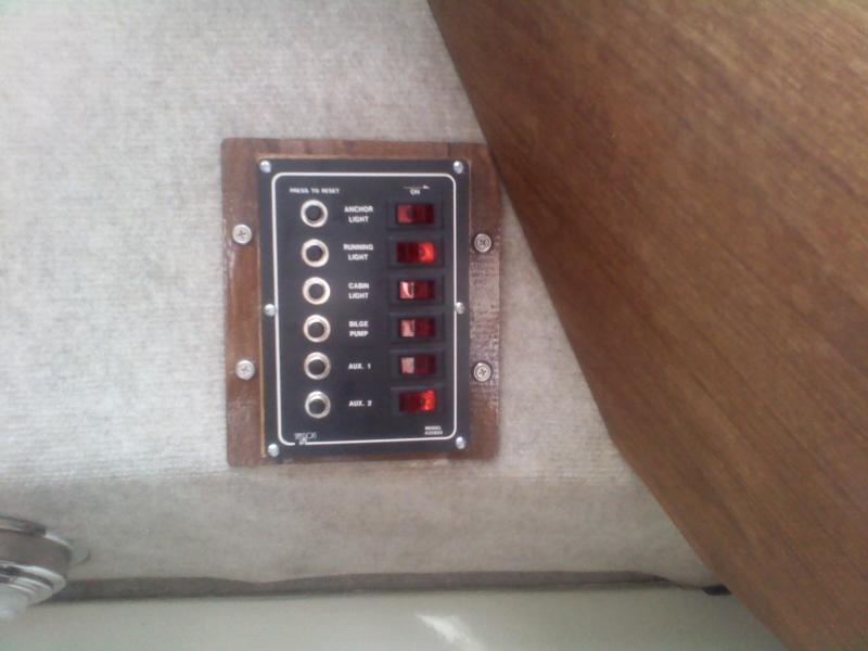

Well, things are moving along. Today I completed the install of the new switches/circuit breakers panel. When I first started last weekend, I just plugged it in, hanging out of the wall to investigate lighting. To get it mounted, I had to cut out a larger rectangle in the bulkhead behind it to fit he switches an backs of the breakers into the wall. The configuration was slightly different because this was not an exact match with the old one
because I upgraded from glass fuses to push button breakers. I am not at all a woodworker but have friends who are, one gave me a nifty oscillating saw, I could neatly enlarge the rectangle while working very closely to embedded wires in the opening. Another friend made up a box for me that I had sketched up, just a 1/2 inch deep frame I used to shim the box partially out of the wall because the backs of the breakers were hitting hard against the sloping fiberglass in the back of the the hole.
I had to extend 3 wires coming out of the hole, (heat shrink butt connectors and Dielectric grease used here). I put a few coats of varnish on the frame and finished mounting it today.
