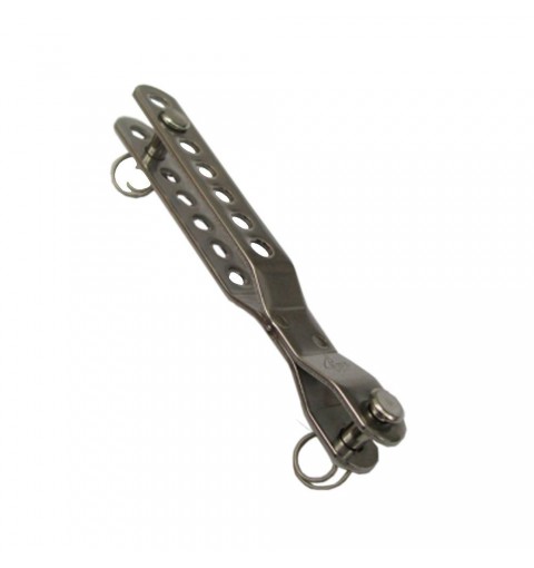

@ghandif15 You might give the company a call.
If you know what it looks like you likely can find one at a local chandler/marine store. Look in the sail hardware area. Ronstan, Wichard, Garhauer, and Schaefer Marine all make good sail boat hardware products.
Most stay to forestay plates use a pin fitting.
Something like this.
The pin gets locked.
Not knowing the type of fittings you have on the stay (end of the turnbuckle) and the deck plate. picking a specific fitting that can work is impossible.
That is why we always suggest an image of what you have and want to solve is needed to get you a best answer.
