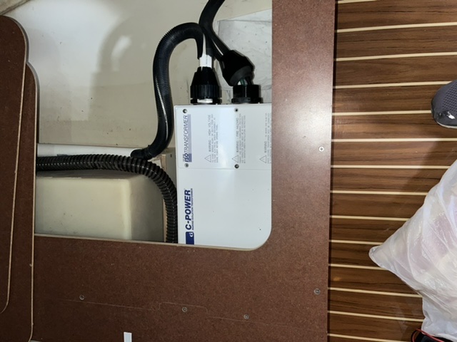

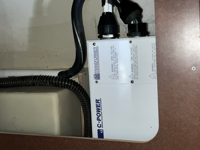

Lastly, if you have the transformer already installed from the factory, I have a rather important tip for you.
Owing to the weight of the xformer, Hunter installed it with the mounting feel downwards, which made the access panel to the taps all but impossible to get into
You want to re-mount the xformer on its side, so that the access plate is facing upwards.
This saves hours of time when you need to access it
