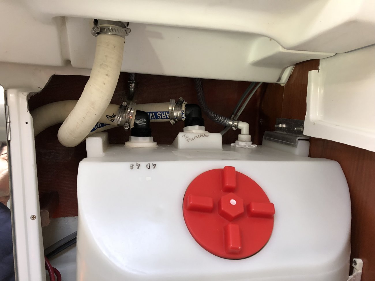

I just converted one of my heads to a gravity fed tank and tore out the macerator and all hoses and a thru hull fitting. According to other 423 owners from around the world apprsrently the French built boats are originally designed with gravity fed discharge..... in addition to the deck pumpout option. Trace your hoses and inspect you tank......
Greg
