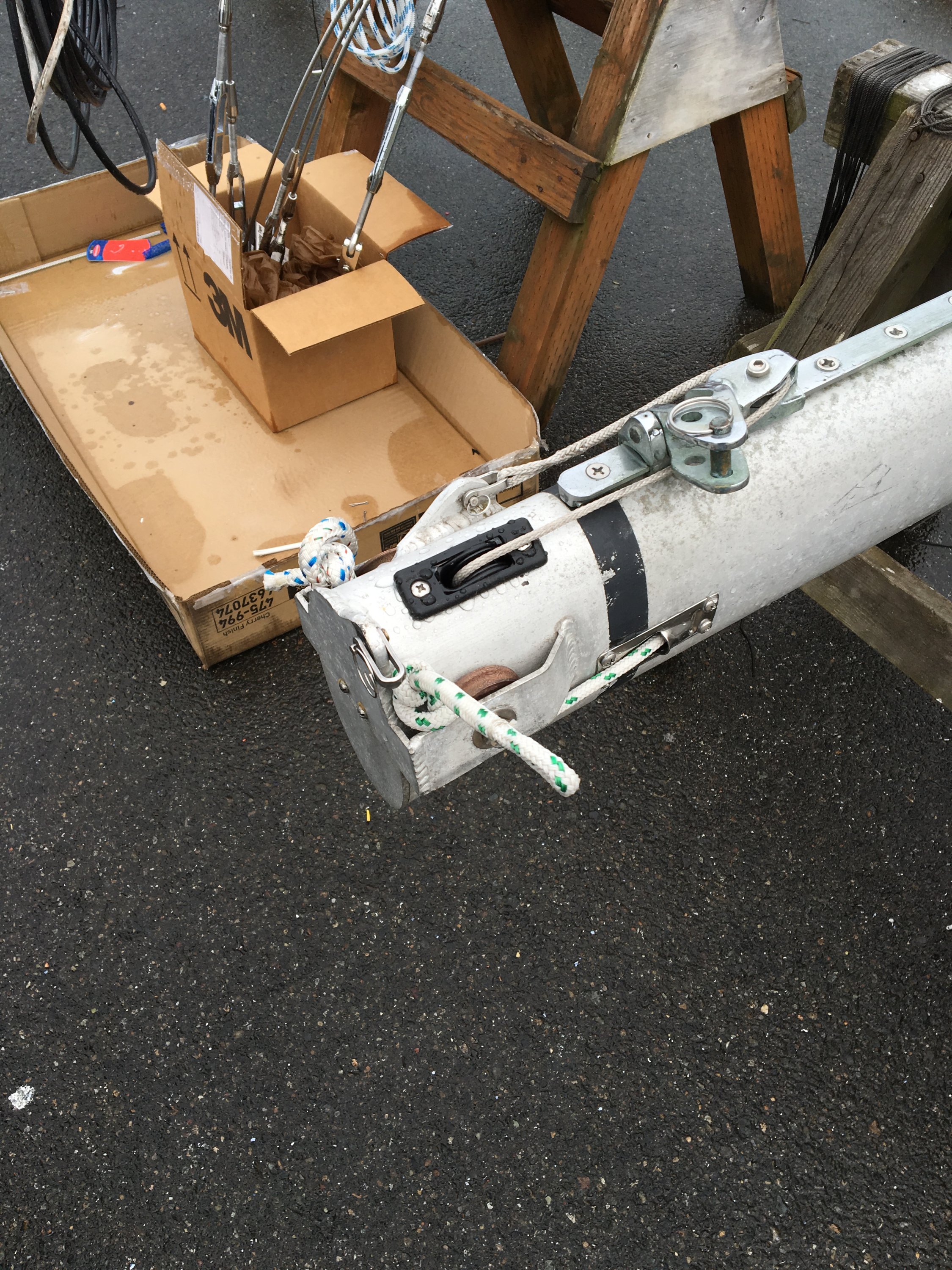

Boom end, showing 2 reefing lines one on either side of the boom end (white/blue and white/green)

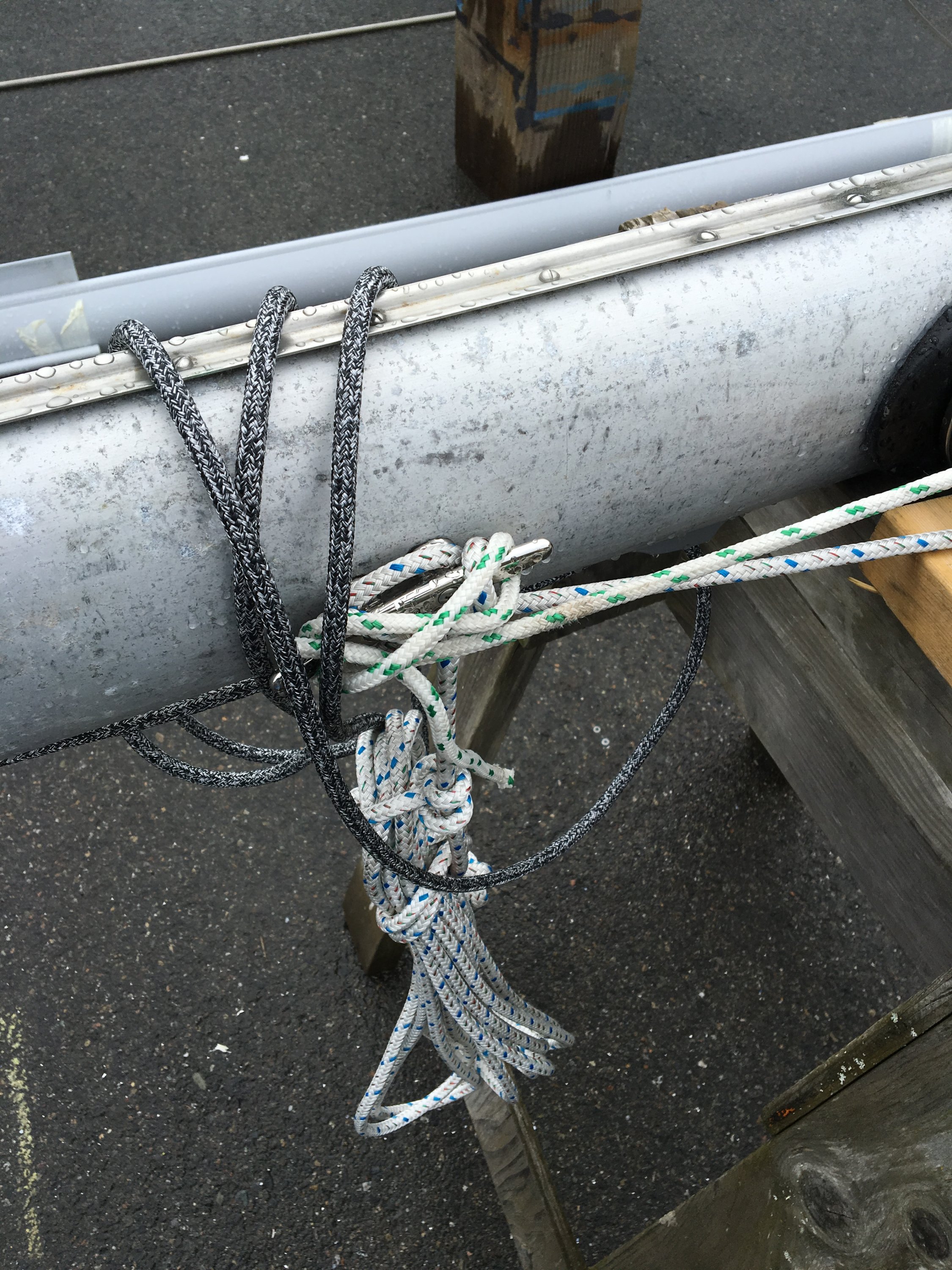

You can see the new black exit for the outhaul. We used a small dyneema line that attaches to a block in the boom.

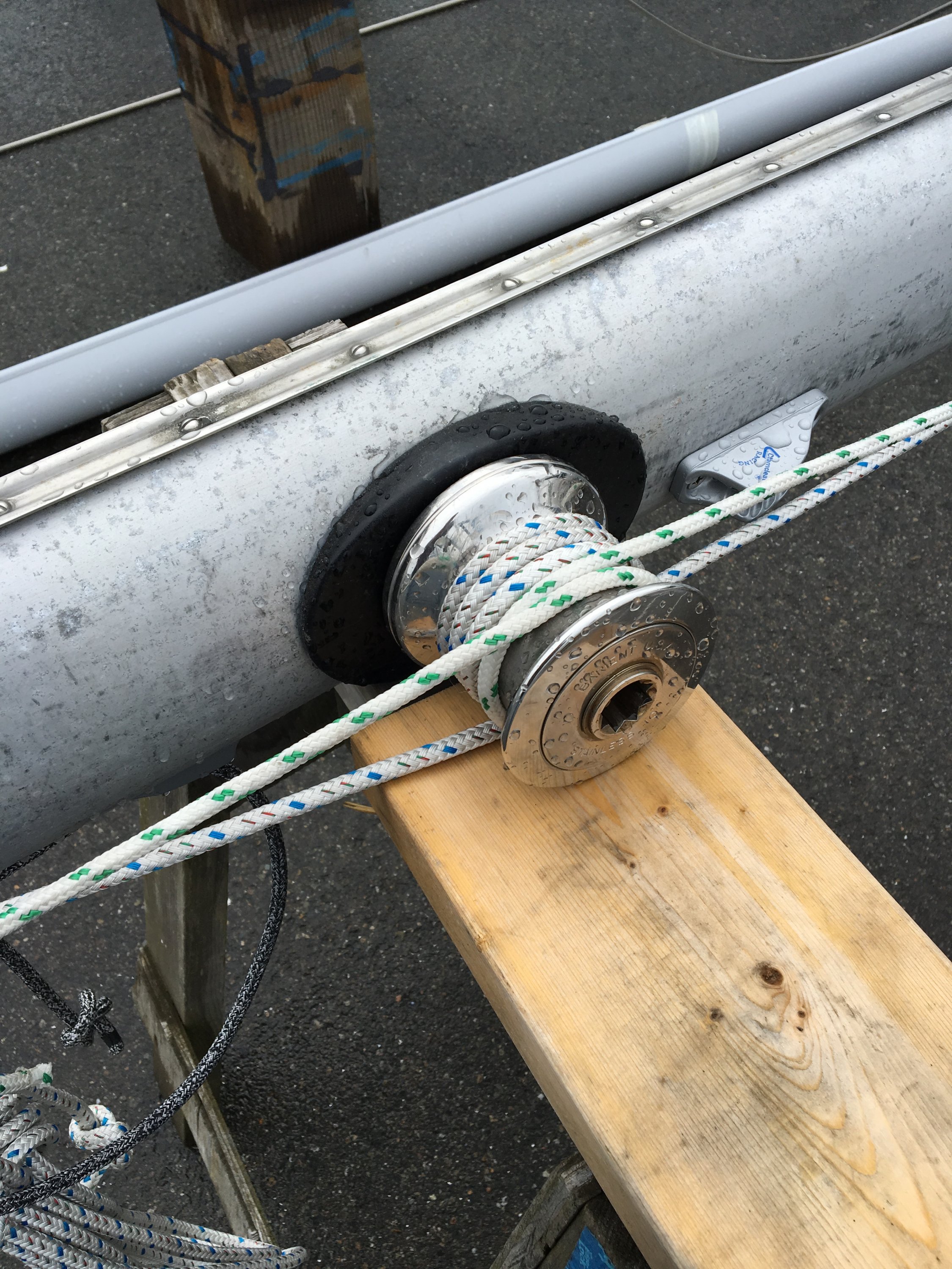

Here is the winch with the two Reefing lines wrapped. The jam cleat next to the winch is to secure the reef line from the winch.

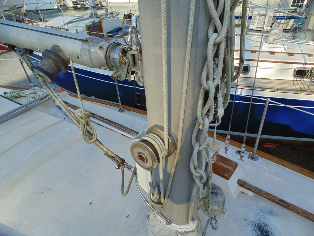

This last image is of the lines on the port side of the mast. The black whit speckled line is the outhaul. Another dyneema non stretch line the is pulled then secured in the jam cleat on the bottom of the boom.
