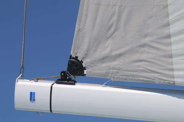

@Jackdaw - Regarding the picture of the aft end of that boom - the tape right now is about even with the aft end of the outhaul car. The clew of the sail could actually move aft an inch or two. Is that the standard range of trim adjustment?
Or asked another way - under racing rules, can the clew of the sail be moved back to the tape and still be in compliance?
Nov 8, 2010
11,386
@SFS , correct, the sail just needs to be inside all the taped marks. The tape is there as much for competitors as the crew. Normally an outhaul has about a 6 inch range. The 0-3 range is for upwind, the 3-6 for downwind. Pulled to its tapes, a correctly sized sail will be very flat.
