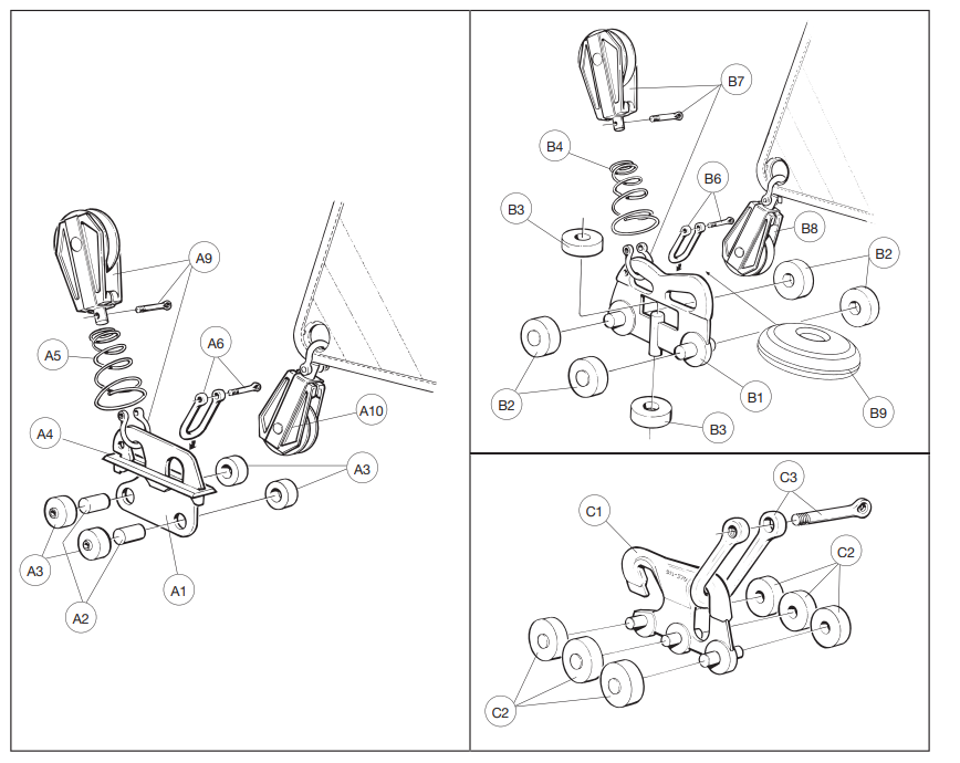

Hello, on our H386 with in mast furling main I've noticed that the car seems to get a bit stuck sometimes. On inspection I found that if I push the car over to starboard a bit it jams up. I've removed the car from the boom and it seems in pretty decent shape. The wheels are slightly worn but I expected to see much worse.
I figure I may as well replace the wheels and put in calls to the local Hunter dealer (no response) and also into a local chandlery listed as a Selden dealer. Again, no response. Aside - what's the deal with such crappy service lately? (This on Vancouver Island)
Just curious if anyone else has run into a similar problem and might have advice? Does anyone know if Selden makes these parts?
My boom car has 6 vertical wheels Part No. 504-500, and 4 horizontal wheels Part No. 504-501.

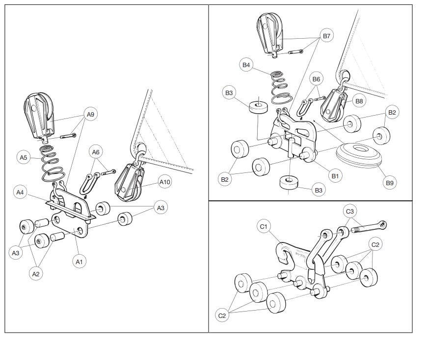

I had a 386 for many years and now 46. I have replaced other parts but not parts B2 and B3 on your in-mast furling boom. I would go ahead and replace the parts, if you can, and if not find a rigger familiar with the Selden mast and boom. In the meantime, if you get it resolved please let the forum know in the event others encounter the same issue.

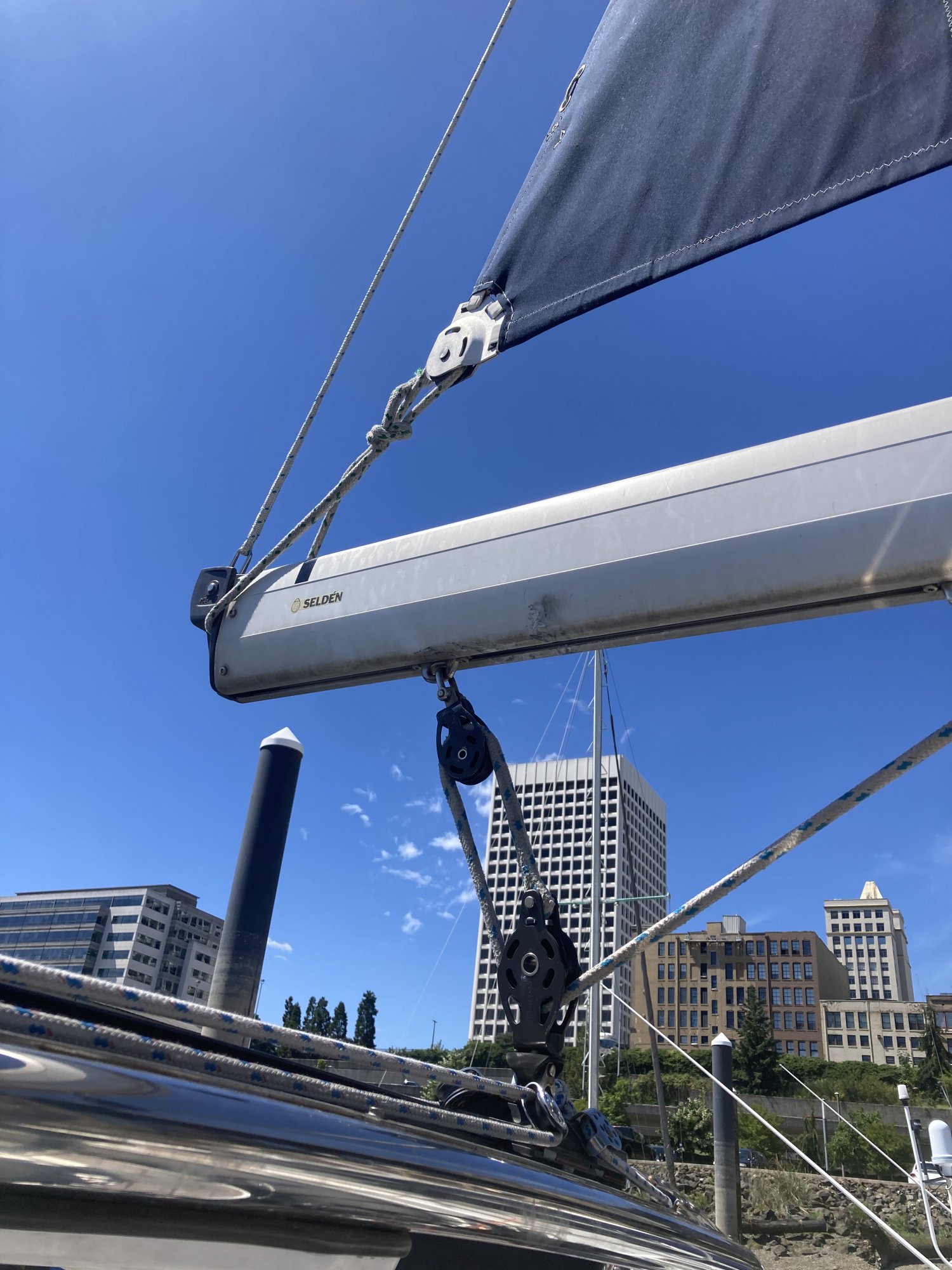

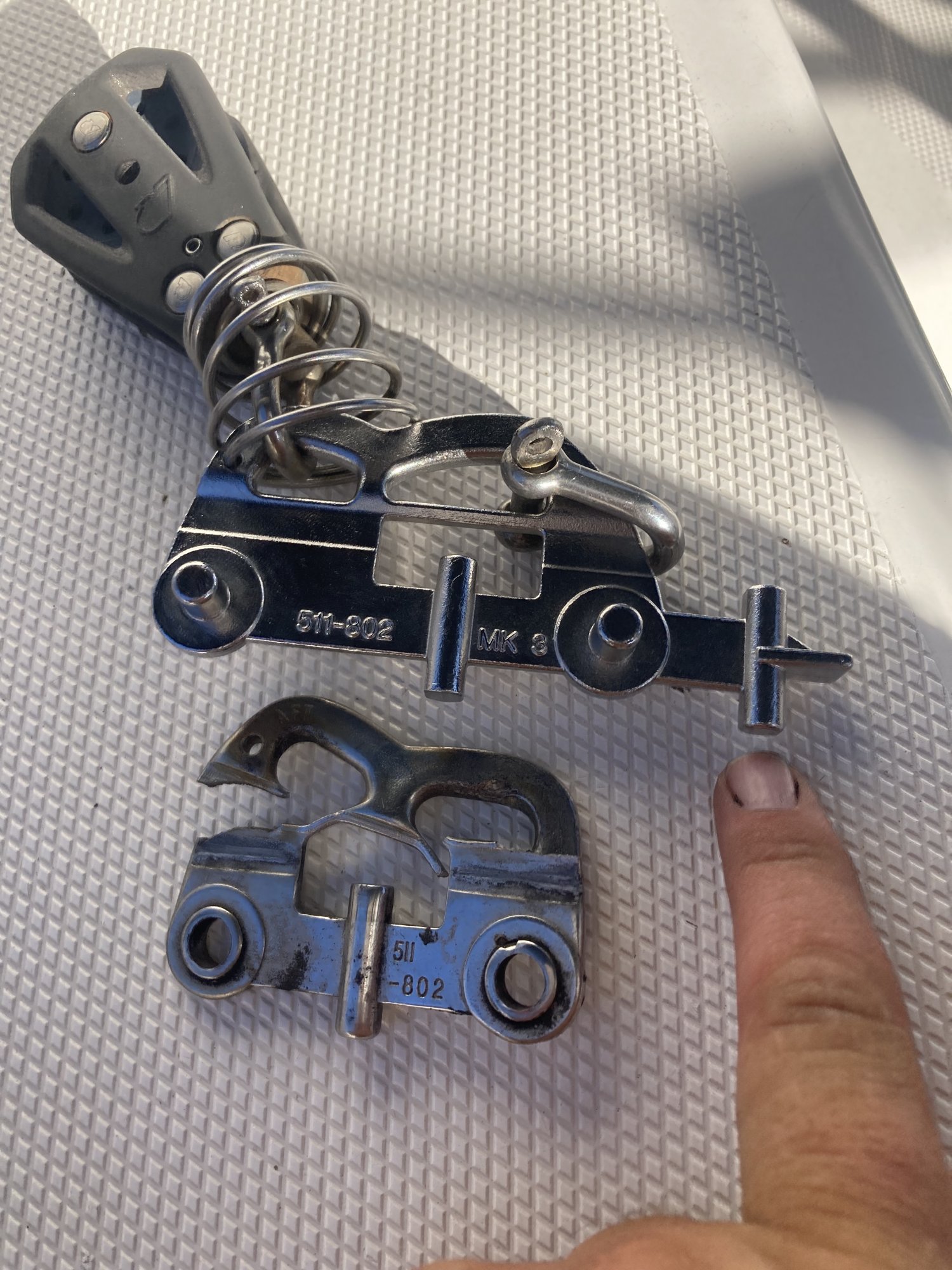

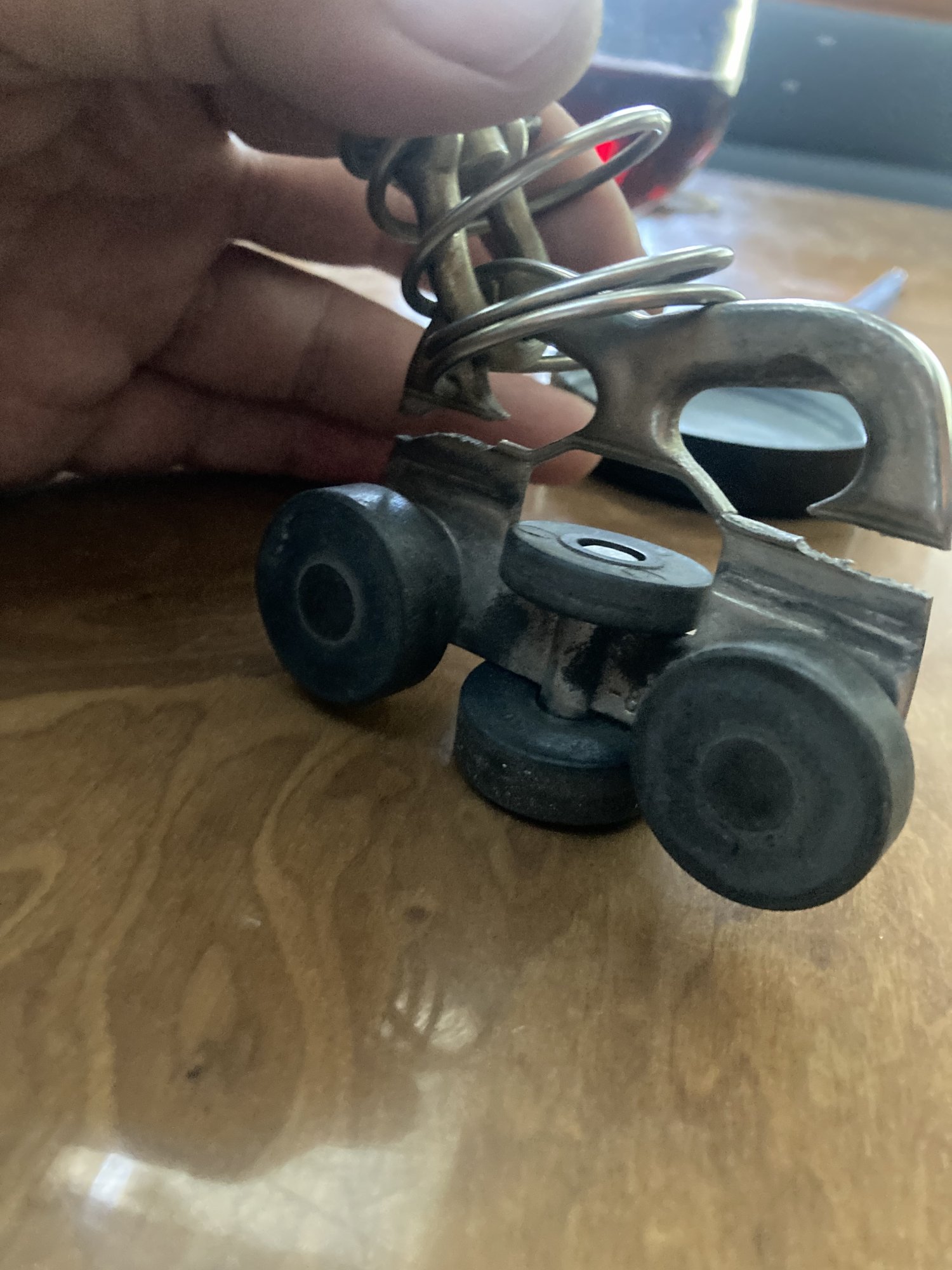

Sailboat Owners has ordered it. I have never accidentally gybed this boat, but I bought it out of the LA charter fleet 18 months ago & have completely restored mechanical/electrical/rigging/ground tackle. I’ve had my eye on the fatigue of this car for a while. I subjected it to 15-20 reach recently. That was when it pulled apart.
Wind is now so light, I’m using a nice jury rig until the part shows up. Attached
