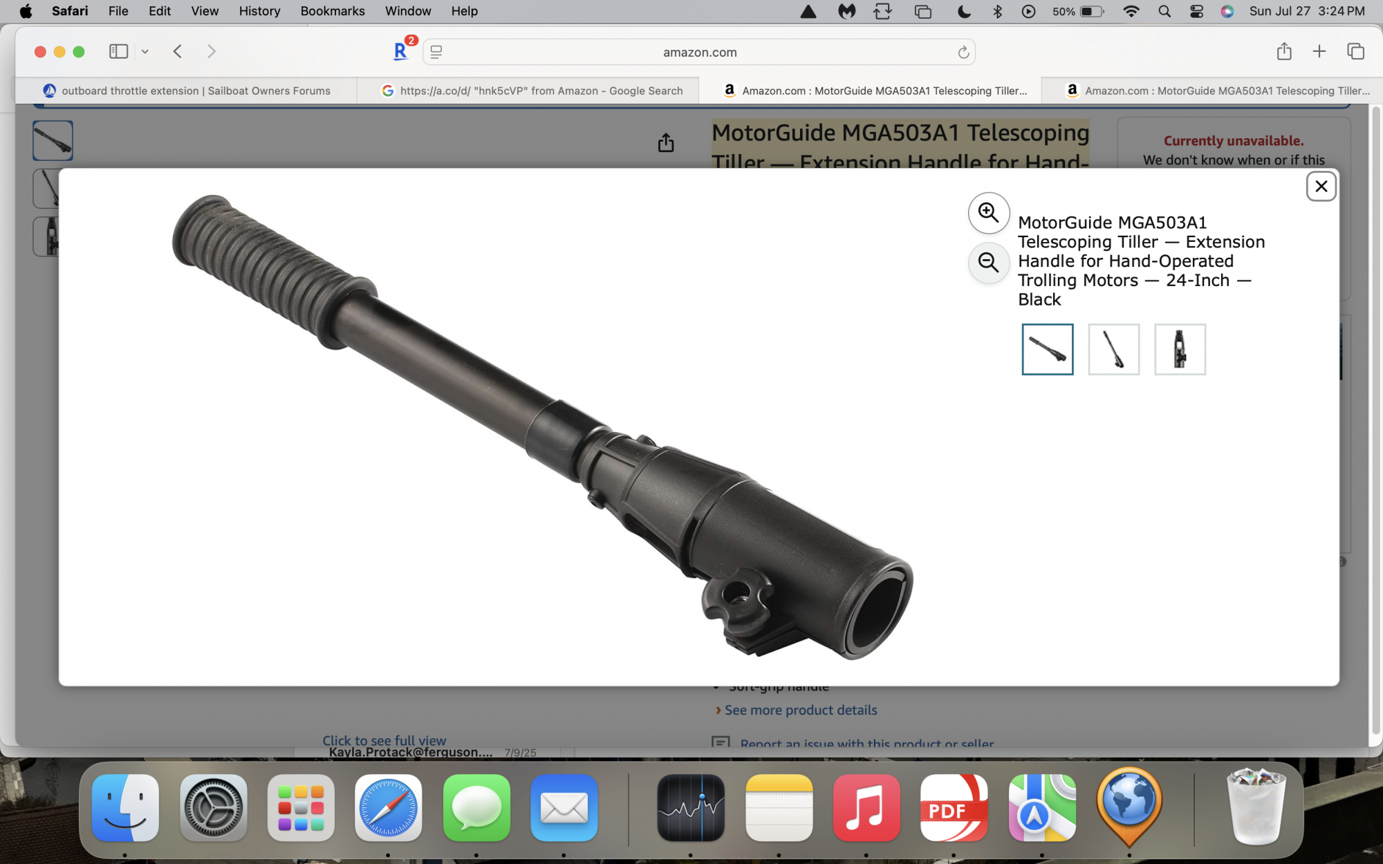

I have one on my 7.5 foot inflatable dingy engine which is a Honda 2.3 HP. I like to be able to sit forward on the bench to help balance out the dingy. The Motor isn't powerful so really it doesn't plane like most larger dingy's with 10-15 HP engines. For me it's a means to get to the shore, to walk the dog, trash removal when anchored at a mooring or just playing around.
From Amazon

I see a lot of DIY types of these that involve a PVC pipe with ID close to throttle OD, some slits cut in the end to allow it to expand/contract a little, and a hose clamp once it is slid over the grip.
Basically free, and the same principle and function as the store-bought ones. If you want a grip, a bit of hockey or handlebar tape on the end.

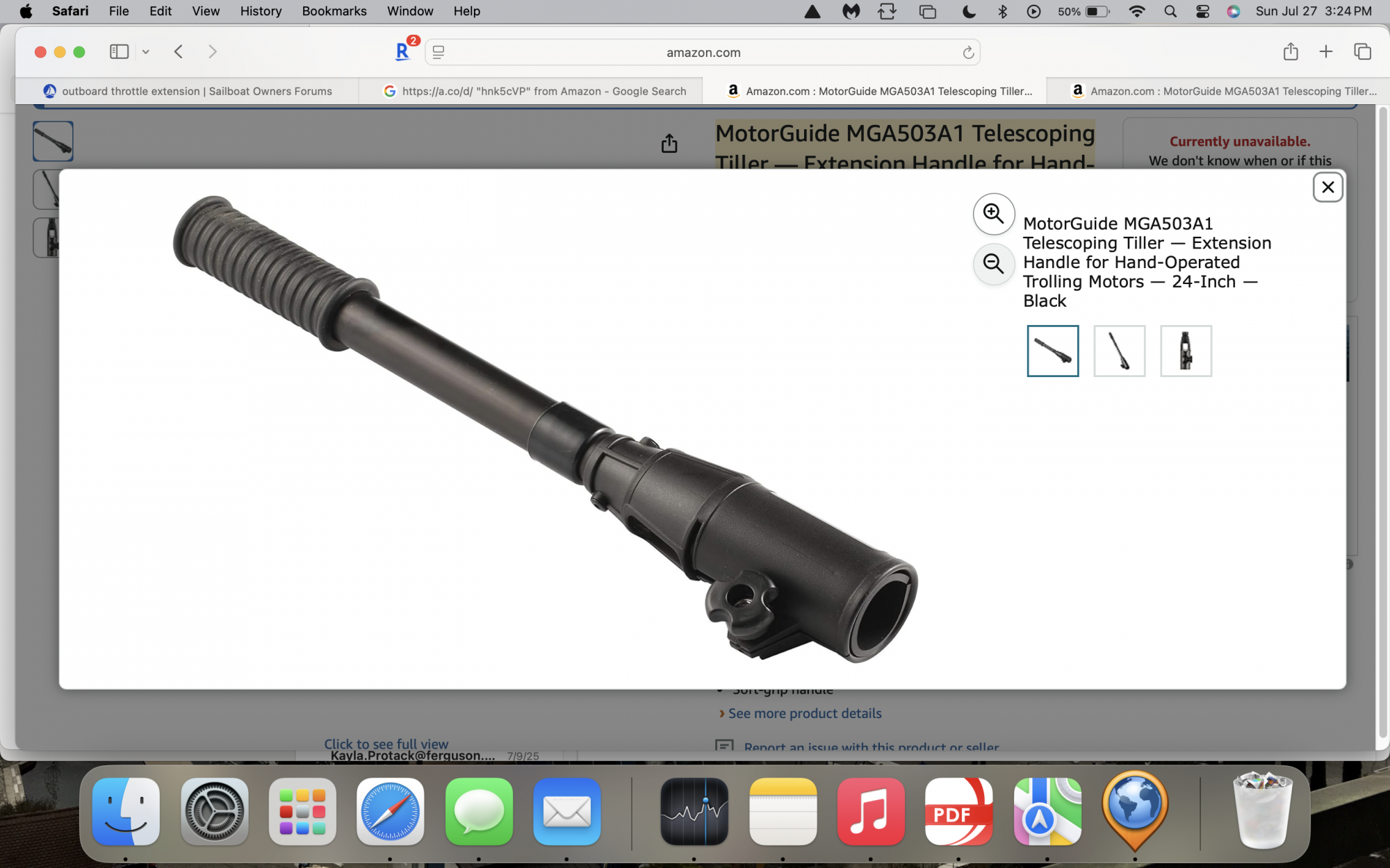

From AmazonView attachment 233270
